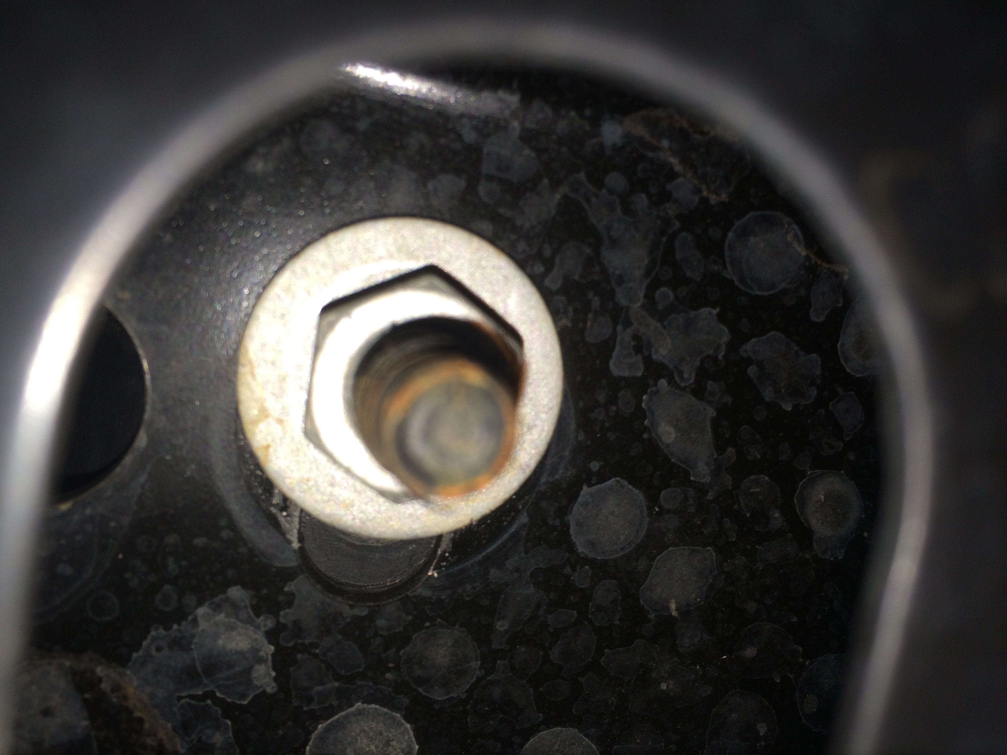

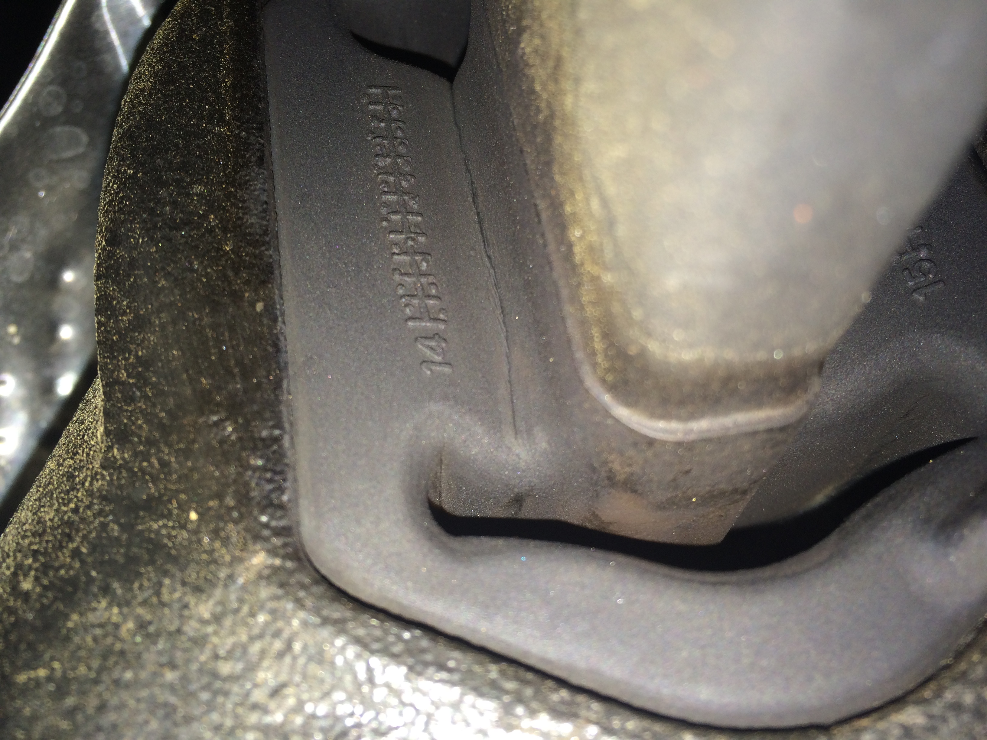

Alright, first and foremost I understand Jeeps are meant for off roading not hitting other cars. However, sometime stuff happens in this life. About a week ago I was involved in a 10mph fender bender. Other than minor damage to the bumper the jeep was fine...from what I thought. However, a few days after the collision I began to feel an annoying vibration in the steering wheel, the gas pedal, and steering wheel. This vibration is only noticeable at idle and low rpm driving. I did my research and determined the problem to be in the motor and tranny mounts. My question is, how hard is this to fix? I am by no means a mechanic, but I am able to do things with a little guidance. Im going to attempt to post pics of the motor mounts for yall to distinguish whether or not they are actually damaged. Also, there will be a pic of on of the tranny mount bolts that is clearly moved forward a 1/4 of an inch at most (clearly somethings shifted around during the collision). With all this in mind, I took it to a collision shop and they said they could not any feel the vibration and it felt normal. I just hope I am not crazy and there is something actually there to be fixed. Any help will be appreciated, especially if you can guide me in changing out these mounts.

Loosen those three transmission mount bolts and move the transmission back to where it was and your vibration will go away. It'll cost a few minutes of your time.
I had a similar problem with mine after an accident and I got the same story. They brought in "experts" and couldn't find any problems after two weeks. It took me ten minutes to notice the shifted mount bolts.
So you can loosen those three bolts then use a ratchet strap to pull the transmission back to where it needs to be. I don't recall where I pulled on the transmission but it works. I did a similar pull to reset the mount after pulling and reinstalling the transmission.

Alright, Ill go try it out. Thanks a ton. So the motor mounts looked alright to you?
Old Jul 13, 2016 | 03:55 PM
karls10jk's Avatar
Posts: 5,642
Likes: 486
From: Knoxville
I would straighten out the trans first then look at the motor mounts if the problem persists. When dropping the transmission, you can set the entire drivetrain at about a 30* angle and the mounts for the motor don't sweat an ounce.

Holy mother of god, it worked and you sir are a genius. I didnt even have to use the ratchet strap. I simply loosed the bolts and pushed up on the tranny. It shifted right back into place where it originally was. Drove her around the block, problem solved. Thank you for the help.

Wow! Thank you so much for the extra detail!! Here are the three bolts from mine. All three, the top is the front. So if it has shifted, it definitely went forward. I guess the makes sense inertia would do that if I bumped someone.

It doesn't look like yours have shifted, you'd see pronounced corrosion in the form of a circle towards the rear if they had shifted. Do you have more details to where we could try to help you diagnose or are you still in that litigation period where you're not supposed to publicly/ privately discuss it? AND even then.....please bear in mind that you're still on the hook for a short while afterwards so you've got to use select terminology when describing the incident. We're here to help, but it doesn't look like you've got what I had. Mine was a rear end collision with another vehicle traveling at highway speeds. Jeep stopped, motor and trans slid forward.
