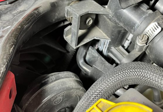

I installed a Griffin 5-00512 almost exactly 4 years ago. granted, only 30k miles on the jeep since then but no issues. At the time it wasn't much more than a factory radiator. The only thing I don't like about it is the cap, which is not factory, and does not come with the unit. I did have to replace that cap one time due to a small leak.
I agree that flexing in the frame is likely the case of these things. I use blue loctite on those top screws and just don't crank them down all the way so that the radiator has tiny room to move.
