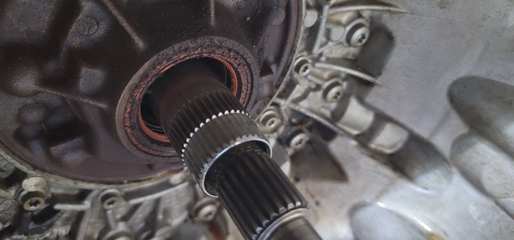

Just had this exact thing happen on my wife's jeep Saturday. I have yet to take it out but on the hunt for a good replacement on the cheap. You ever get any info on what causes this?
Old Sep 20, 2024 | 08:25 PM
Msweber97's Avatar
Joined: Sep 2024
Posts: 2
From: Greenwood Indiana
Sure enough that's what it was, anyone know how this happens?
