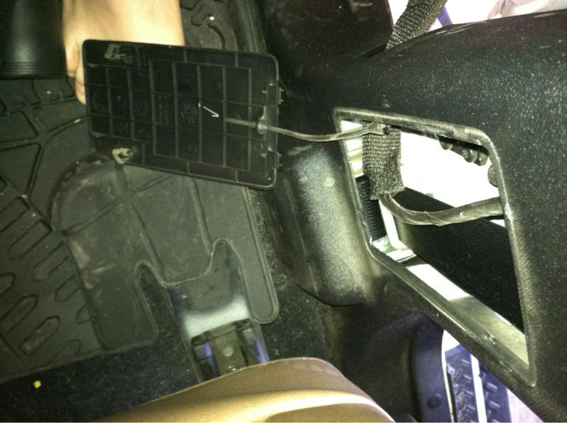

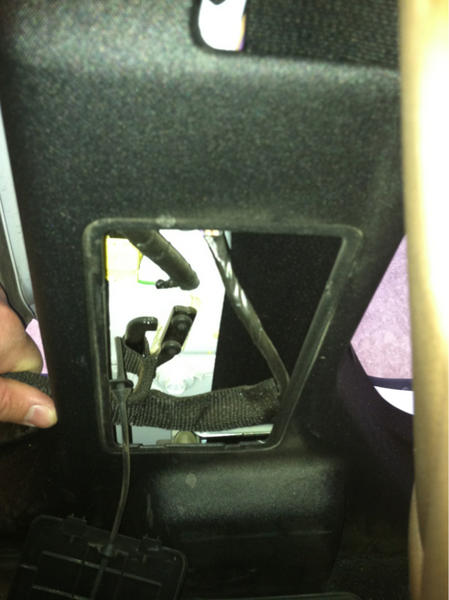

Sorry I should have been specific. The panels on both the left and right side where the cord connecting the doors goes into; how exactly does that come off? I've tried pulling a bit but that obviously didn't do anything. Are there some screws that one has to unscrew?
No screws. Just dig your fingernail into the top of it and rip it off. If I remember correctly that's what I did when I took my doors off last summer :p
Old Mar 29, 2012 | 07:17 AM
RedOffRoad's Avatar
Posts: 1,088
From: Omaha, NE
yea the panel isnt held in by much, its just a pressure hold with plastic lip, it pops right off with a little tug, then release the red clip on the harness, unplug. Take the strap off the hook, and lift your door off. It might be kinda hard if you never have before as it has sat. but work it and it will come off (just remember the door pin nuts need to be off)

One end of the panel has a clip and the other has like a j hook. I think the top is the clip and bottom is hook. But yeah, what the others have said, pull it off and everything is behind that panel

Make sure front seats are all the way forward..
