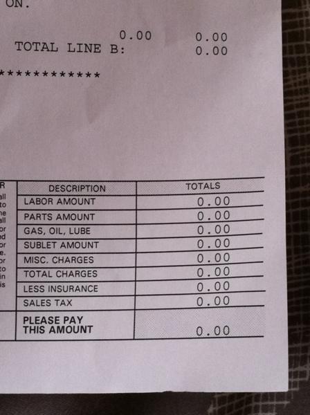

Ok drum roll please...
I picked my baby up last night and here is what they said on the maintenance sheet:
The technician checked the codes with WITECH, has code P2111. Performed diagnostics per sheet and test passes. Cleared code and road test, vehicle will not accelerate over 40mph. Returned and checked for codes, no codes found. Perform ETC Relearn Procedure. After Relearn, getting codes P2115 & P2116 for acceleration pedal sensor. Can see pedal sensor readings changing with pedal movement. Perform tests per sheets. Replaced PMC control module and program to vehicle and Relearn ETC. No codes after repair. Internal failure of PMC. Road test, vehicle will still not accelerate past 40mph. Check for codes, no SPTORED. Perform visual inspection of all sensor connectors and found water in crank position sensor connector. Blow water out of connector and add dielectric grease. Road test, vehicle performing properly.
So thank you all for your advice and suggestions, you guys are awesome on here and probably do this kind of thing for everyone, but this is my first Jeep and I gotta say it feels like one big family, from waving to each other on the road to help like this on a forum, never got this with any other vehicle I've owned thanks again everyone!!! Time for a Sunday drive sans doors...
