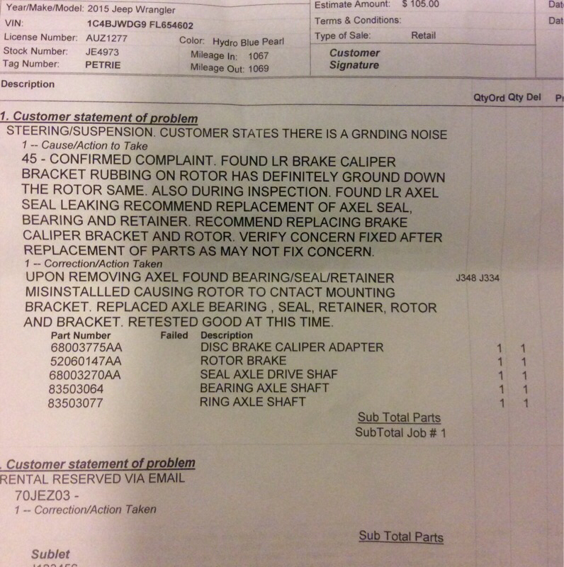

Old Nov 22, 2015 | 08:36 PM
Kellen's Avatar
Joined: Oct 2012
Posts: 262
From: Kitsap Co. Washington
Had this.
