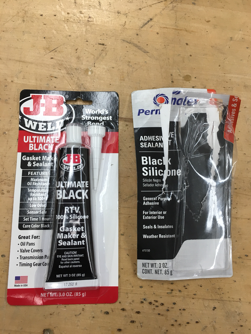

I did my JK diff front and rear about 3 weeks ago and wanted to do the same service to my girlfriends 2004 grand Cherokee.
I used regular black silicone adhesive rather than the recommended RTV black. I just got the wrong one out of my tool box kinda in the zone with the tunes on.
Do I have to do the diffs over again? Wait and watch them and see if they leak? My gut tells me to just do them over again correctly but I don't think it's a high temperature area that requires the regular RTV.
Please let me know your thoughts. Thanks in advance. On a positive I used the black RTV on my JK 3 weeks ago so it's only hers to worry about. I'm on the permatex website and it looks like they have green specifically for differential because additive may eat away the gasket.

[QUOTE=EHarris;4308893]I did my JK diff front and rear about 3 weeks ago and wanted to do the same service to my girlfriends 2004 grand Cherokee.
Please let me know your thoughts. Thanks in advance. On a positive I used the black RTV on my JK 3 weeks ago so it's only hers to worry about. I'm on the permatex website and it looks like they have green specifically for differential because additive may eat away the gasket.[/QUOTE
You're fine. It's a low heat application.

Pffft.... hold what you got. Watch it and if you see it seeping, then change it. (I doubt you will though)

Ok thanks boys. I was super bummed when I saw the mistake but figured it couldn't have been that bad. I'll make sure the cheap shit is out of my tool box.
How about the green label specifically for diffs? My buddy has some aftermarket covers and I was thinking about the green over lube lockers.

if it's seeping, clean up cold diff bottom with brake cleaner and add nice smooth layer of RTV at the lip I peeled a diff cover a while ago on a trail, pounded it back, waited for it too cool at camp, added RTV and then drove for almost a 1000 miles before I was changing diff oil again and had no leaks
