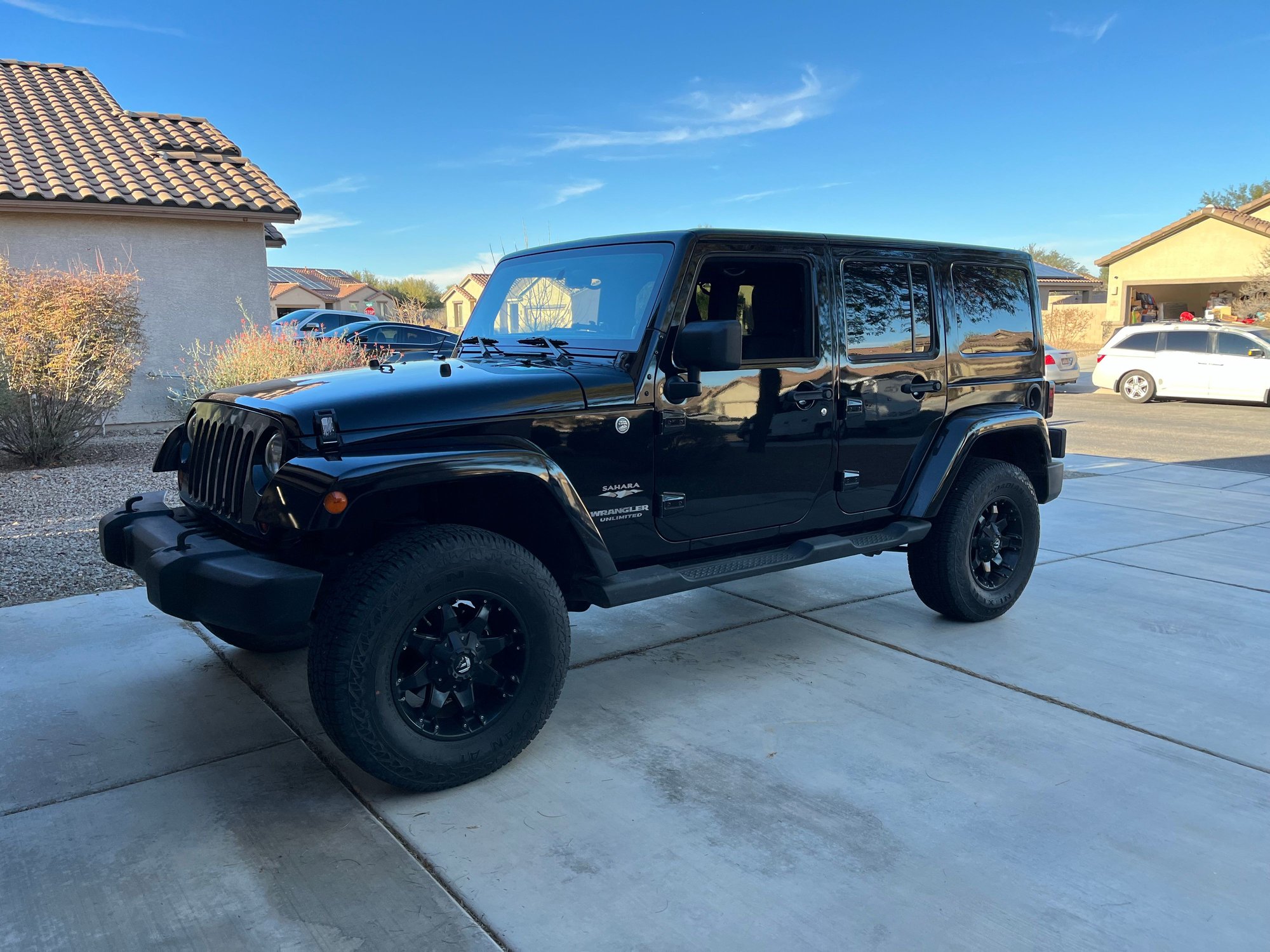

I just installed a teraflex 1.5" level (spacer) lift along with new Bilstein 5100 shocks (1-3" lift). I needed shocks to pass inspection but didn't want to replace with stock length as I plan to go with a quality 2.5" lift package eventually. Here it is shortly after sitting on 285/70/17's (33's) with stock fenders.
The wheels are also on 1.5" spydertrax spacers which helped improve the stance a lot.
I have recently went to high clearance fenders and am now wanting to go up to 35's as the 33's don't fill the wheel well's as much as I'd prefer but these K02's only have about 15k on them so I'll probably wait it out until I decide to go taller and add all the adjustable arms and trackbars.
For what you're describing I would stay with something around 1.5" / level which would also let you continue to use your stock shocks without extensions .. teraflex also makes a spring level kit as well if you want to avoid spacers but since my long-term goals were to do a larger lift I just went with the spacers for now as I'll probably replace them in another year to 18 months.
Here it is with the new fenders and inner liners

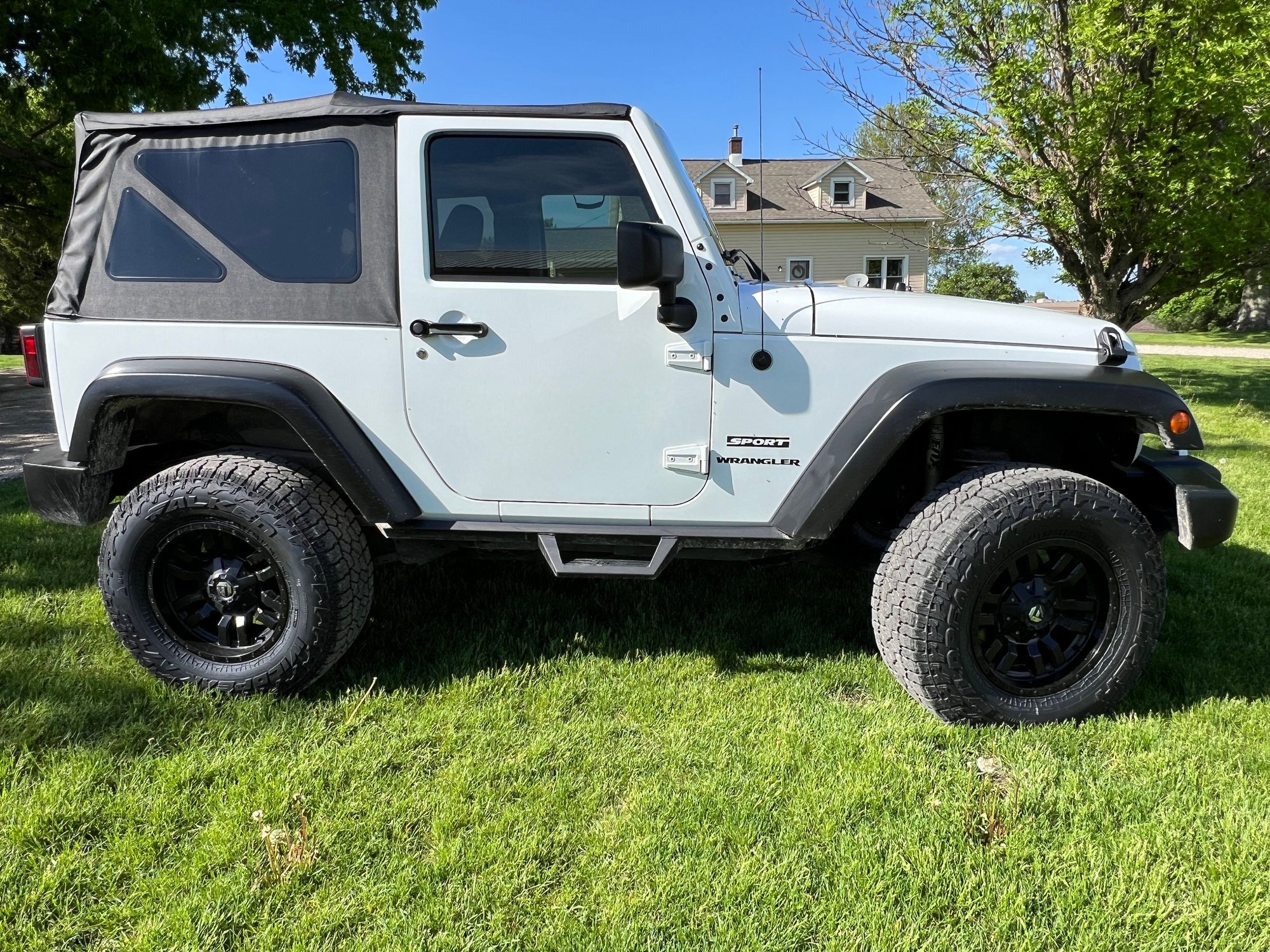

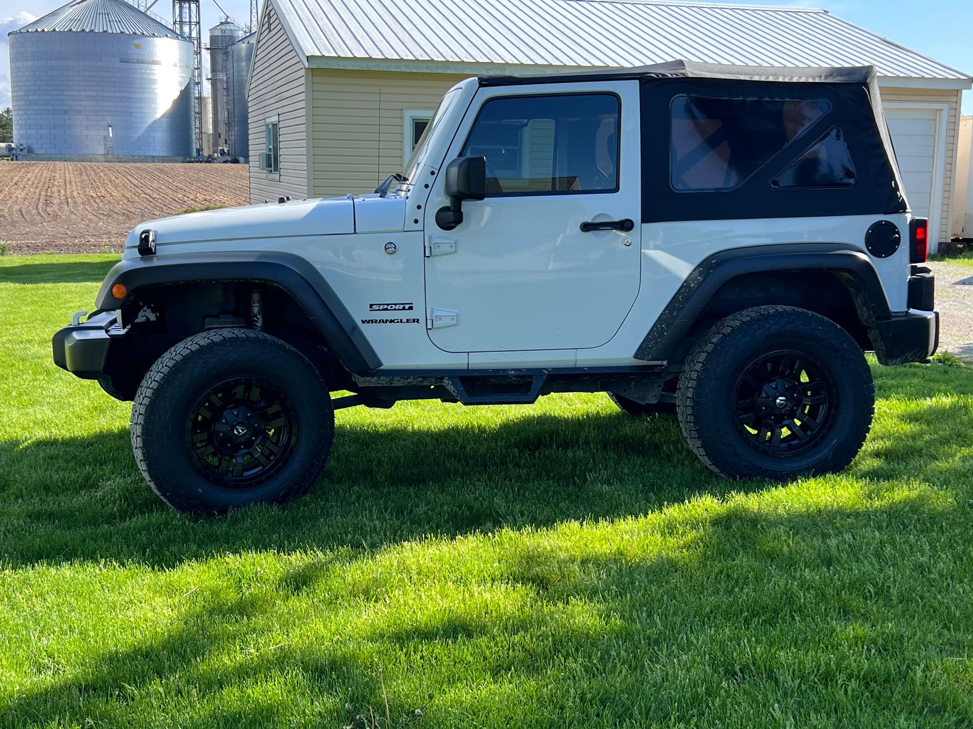

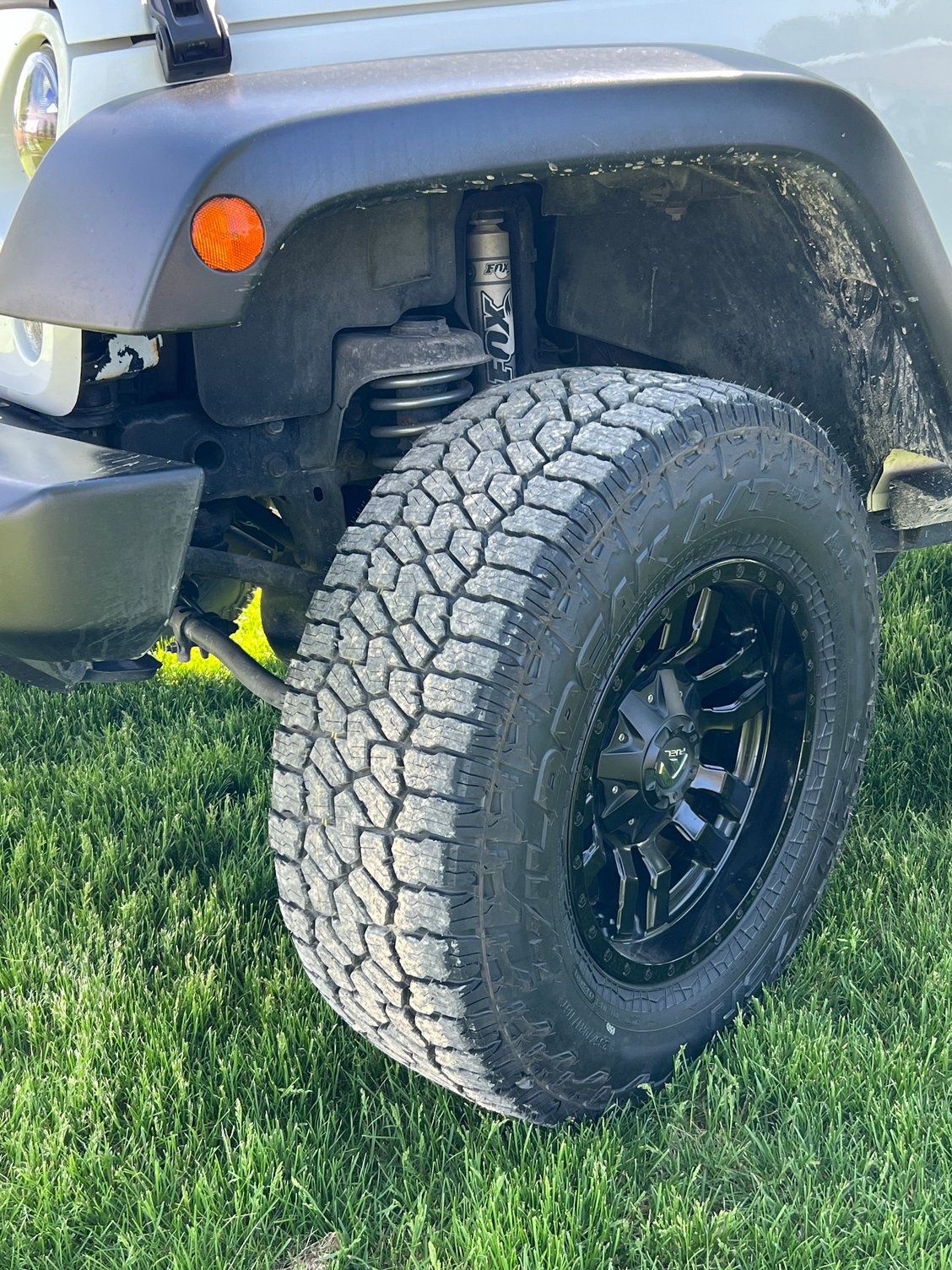

Default Complete for now
Rough Country 2.5” spring lift FUEL wheels.. Falken 285/70R-17
AT4W
Really wanted a hard top .., bought one … soft is growing on me now…. Next up bumpers , swap the tops …. Then well some stuff i don’t need.
