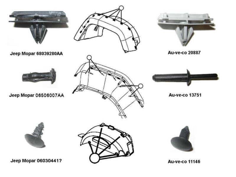

I just removed all 4 of mine had them painted and replaced. I ordered all new fasteners online in bulk and tried many different ways of reinstalling. What seemed to work best (after breaking many of the new clips) was to install it already riveted together as one unit. Once I figured that out other side was a breeze. I couldn't find a plastic rivet gun locally so drilled out one i had. This worked but wouldn't pull rivet tight enough. I used a small wrench to hold rivet while pulling with pliers to start and then finish with rivet gun for nice tight flush break. This picture was helpful showing all the fasteners and fastening points.
