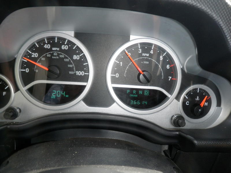

OK, so I went through the search and read a lot on overheating. However, my specifics seem to be somewhat different.
1. I know my fan is slightly damaged from mudding, since last time I mudded it made a squeaky noise. However, it still runs and pulls air, albeit it seems to run now more on high, and very noisy.
2. Did a Radiator Flush at dealer, as they suggested it as part of preventive maintenance.
3. Overheated in a hilly stop and go traffic jam:
4. Opened Rad cap and found it completely dry!!!
5. Reservoir was full, so it seems it is not puling coolant into the rad.
6. Filled up with coolant, and again got an overheat in stop and go, but not as bad;
7. No overheating if stopped or when moving at more that 15 mphs.
8. Red light or warning never came up;
9. No codes thrown.
So I think:
1. Radiator cap is not fully sealing, causing a leak in the vacuum and then not letting coolant to flow from reservoir;
2. Maybe dealer did not fill up radiator after flush;
3. Need new fan assembly.
Your thoughts are appreciated, since I will not take it to the dealer!!!
