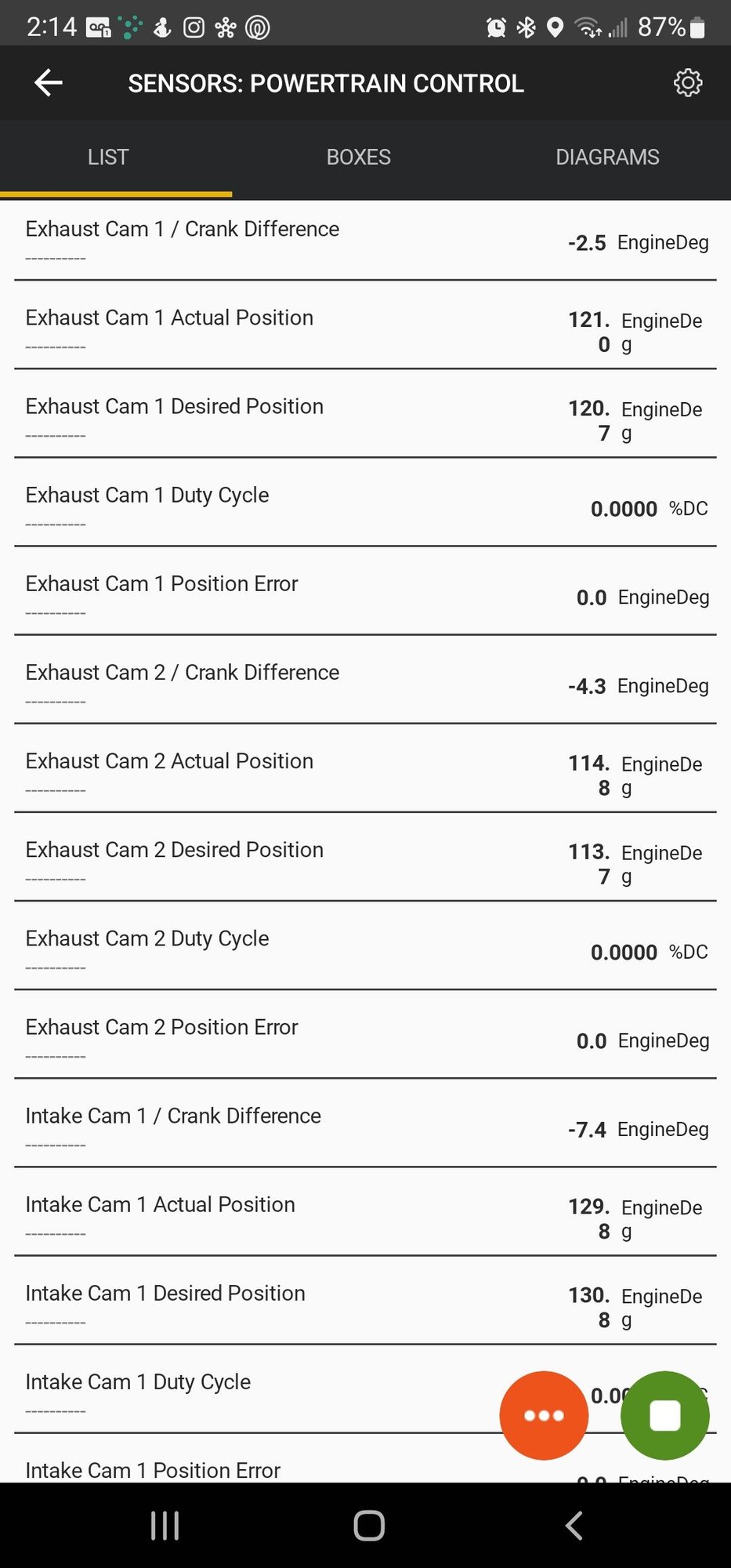

I'd be a little curious to see jscan snapshots now and how that cam is sitting...if it's any different than before. If it's not an inconvenience.
Well I pulled some snapshots from the jscan. and Honestly I don't see much of a difference. But Im gonna do a 2 hour drive to my parents place tonight and ill grab a few more alng the way and see how it all compares. But as it sits, this problem seems to be resolved for now.
