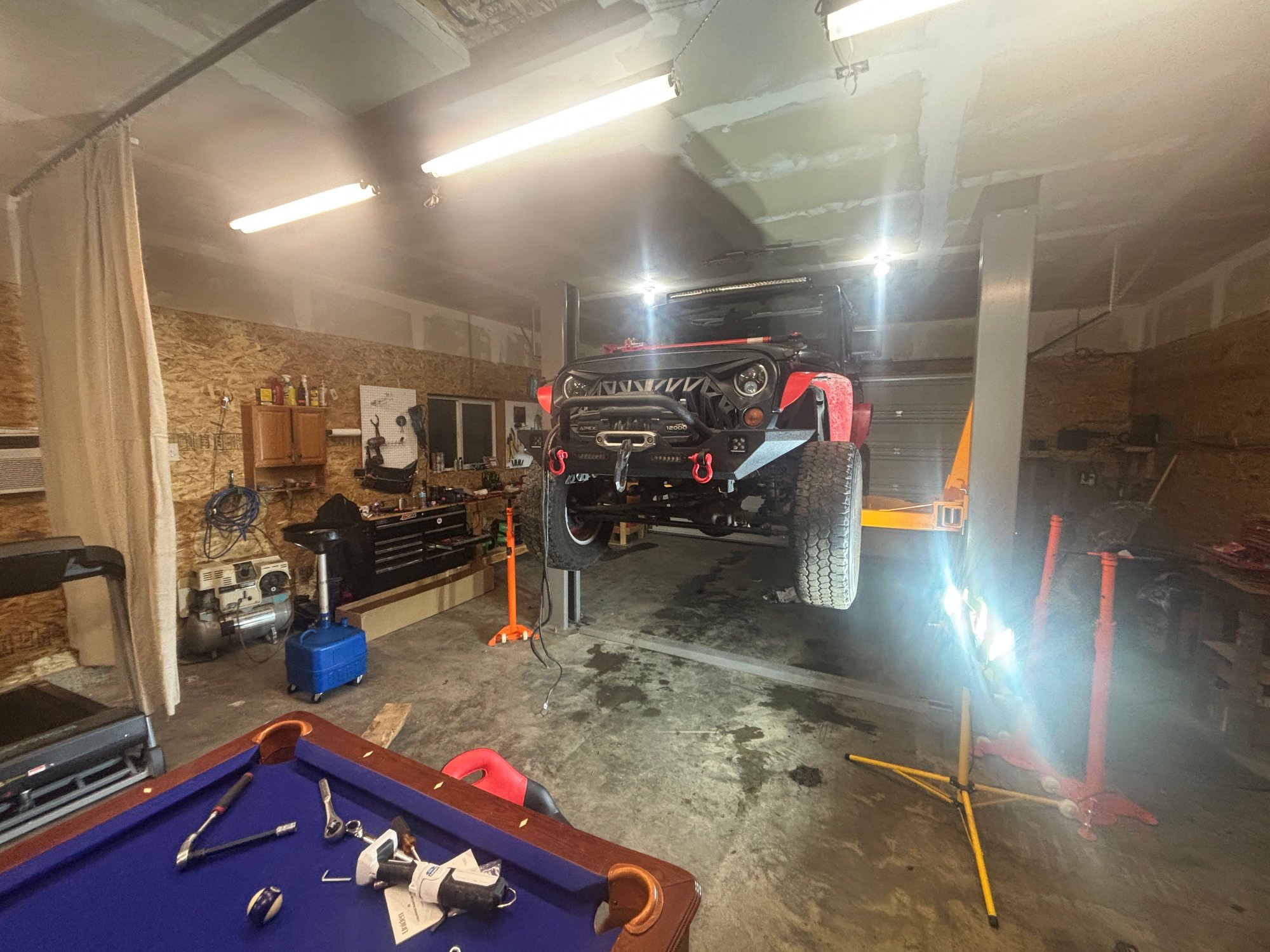

plugged cats. If it’s multiple misfire look for the following
1. Injector fuel leaks. Could be faulty injectors or o rings around injectors. For the price just replace injectors.
2. Antifreeze leak on manifold ( especially rear) if there is then replace intake manifold lower and upper gaskets. Make sure to clean the upper and lower intake with 3 cans brake cleaner when removed since they build up a lot of residue.
3. Vacuum leaks. Ensure all hoses are secure
4 spark plugs and wires
5. Coil pack may need replaced
6. Check fuel pressure if you can ( clogged fuel filter which is internal with fuel pump. Tank easy to drop. 60 bucks amazon for fuel pump
7.stuck egr. Passenger side behind the wheel well covers. One bolt is a pain to get back on but it’s a manageable do it yourself job.
I’ve ran into just about every code and have replaced every single part I think besides engine rods and pistons and heads on this jeep. No joke. So when I see a p0300. First bet is clogged cats. Aftermarket exhaust is cheaper via eBay ( 100 bucks). Cross member and front driveline removal is necessary. Make sure to support transfer case during the cross member removal and the job isn’t terrible. Where the exhaust meets and clamps on driver side midway down the jeep you can swing a sludge at the hanger a bunch of times and where the old exhaust elbows to get it to get loose. I have a lift, so when installing it I used the lift to jack up the exhaust to the manifold while I had another person guide with a crow bar the exhaust into the upper flange. Kinda tricky. But use a floor jack while you have another friend or son help guide and wedge the upper exhaust back in. By the exhaust kits that come with clamps cause where the new exhaust elbows they’re no longer one solid piece and welded. You can weld it or clamp it yourself.
