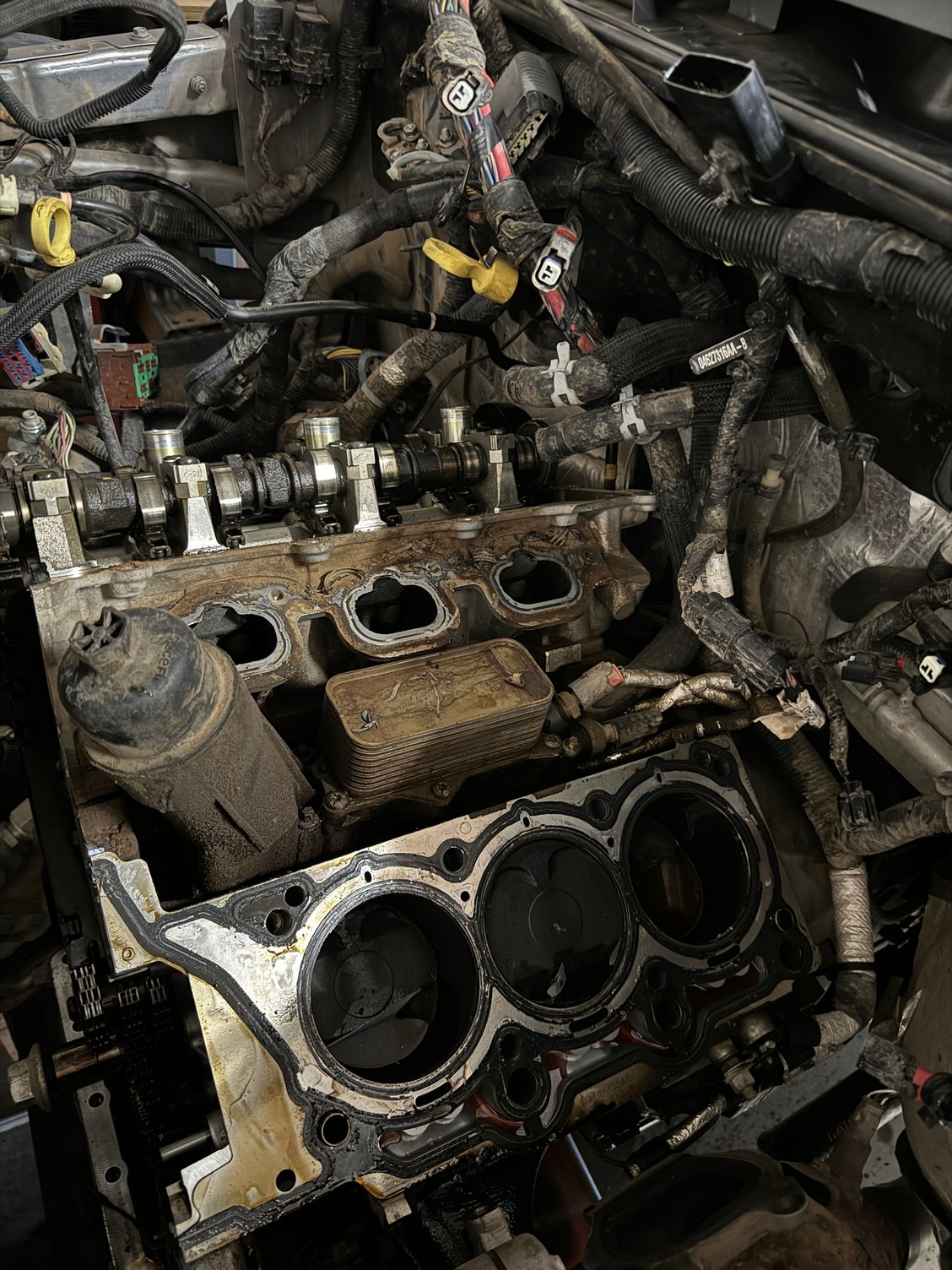

After a couple super busy months at work I finally am able to get back to the Jeep and put it together. I got a reman head from the dealer and all parts. However, I was either a dummy and left some sensors on the core or I just forgot where these connections go. Either way, I have to ask a newb question: what are these plugs for?

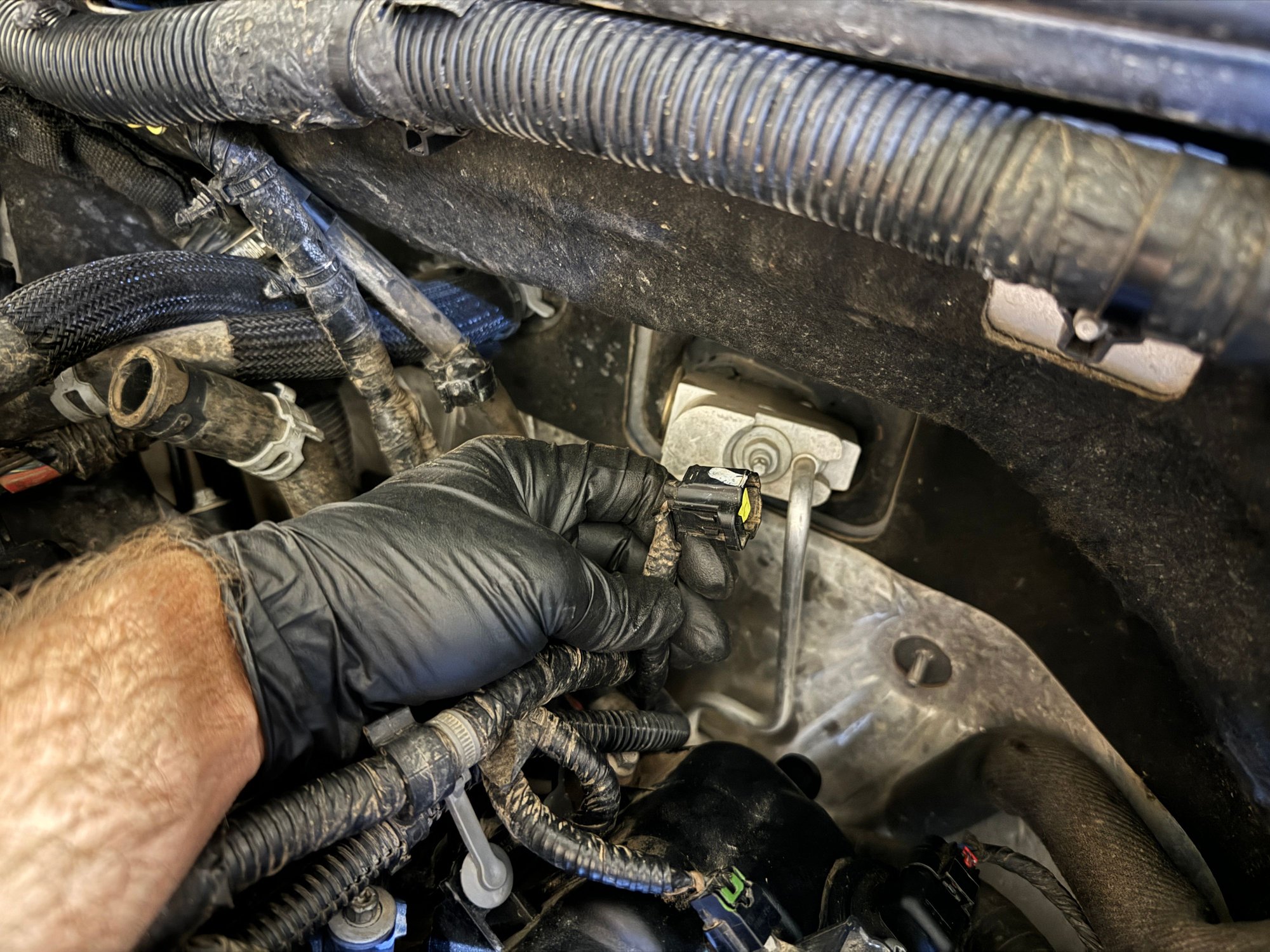

One is located near the back of the left head
I believe this one may be the ignition capacitor?

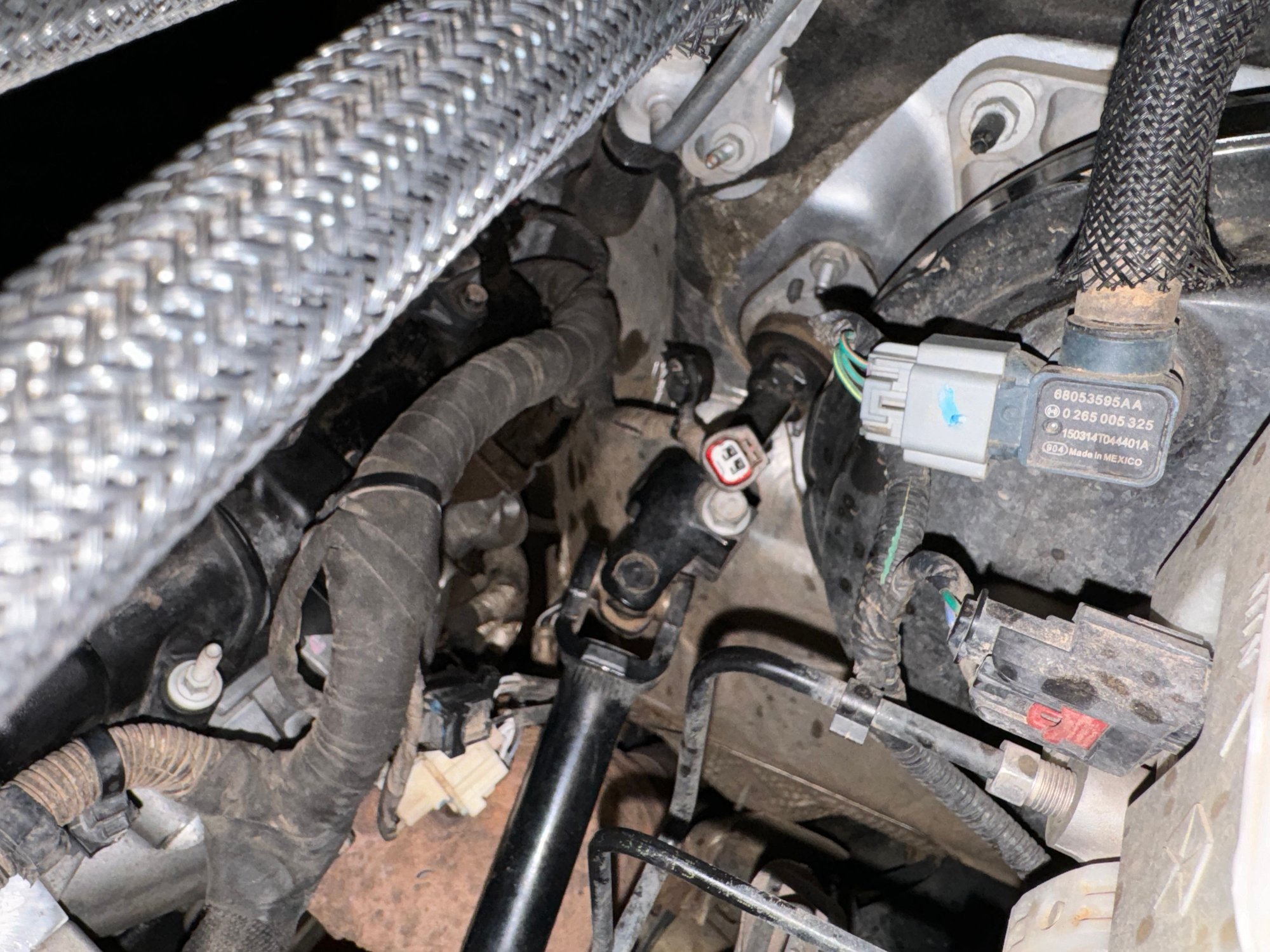

the other one is located toward the rear of the left side of the left head;
can someone verify what these are for?

I believe the plug in the second photo is for the coolant temp sensor.
