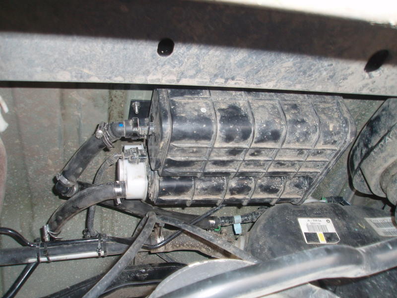

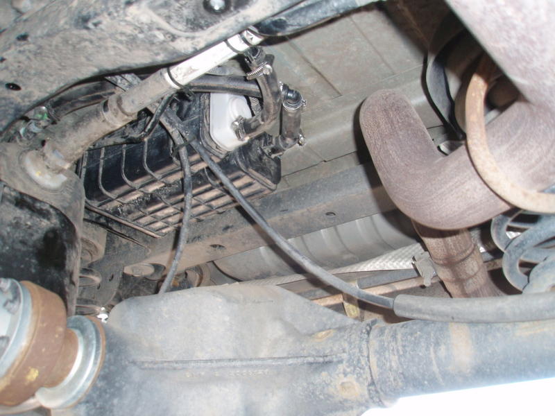

Default Fixed mine!
I had the same thing as most complaining about the evap system. Mine first started with a GASCAP message. After a trip to the dealer they reset the error and it returned a couple days later, this time followed by P0440. Well it didn't take long before I got the P0442 and the failure P0455.
So after reading this thread I thought I would first try a smoke test. Guess what? No leak!
Ok I thought about replacing all the evap parts. I started with the cheapest the part the pressure sensor. it is twist locked onto the evap canister about $10. Reset my computer and presto, problem fixed. Been 2000 miles.
The piece I replaced is that little white box.
However, I wanted to know what the hell went wrong. This is what I discovered and it wasn't easy that little bugger is glued shut and I didn't want to contaminate it with saw dust.
That little box is a sensor. It has a plunger inside with a rubber gasket making a tight seal. Once pressurized it stays in place and sends the signal to the computer that the system is in fact pressurized. I theorize that some of the charcoal dust from the evap canister got through the filter and lightly coated the insides of sensor housing and the rubber seals preventing it from maintaining a tight seal; minimal at first but as it got dirtier it became worse. Charcoal dust although not thick was apparent and prevented a tight seal when I applied a vacuum.
The pressure sensor is a simple device with only one set of contacts in it, no electronics or corrodible components. Mine is now working but I live in Mexico and drive a lot of cobble stone roads which must be vibrating the hell out of that poor evap canister which contains the charcoal. Next time I will take it off (comes off easily) and wash it with water and a little dish soap rinsing it thoroughly with distilled water and drying it completely before reassembling. I think this will fix it just fine.
