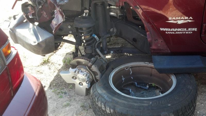

My 2010 Sahara Unlimited was in an accident that damaged the left front including the wheel. The repair shop replaced the front axle housing, tie rod, drag link, lower control arm and supposedly replaced the hub assembly. I got the Jeep back last Friday and it looks like new. The bodyshop did a really good job but now I can feel play when moving the top of the left front tire in and out.
Is there any adjustment to the bearing play on the Jeep front hub? Or does the hub assembly need to be replaced (again or for the first time for real)?
