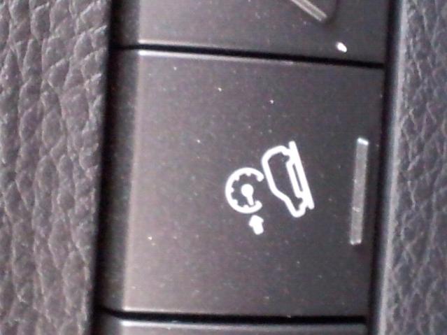

This is the button

Ok, I have hit that button before, but all that has happened as far as I could tell was the light flashed a few times. When I looked it up in the manual, it said that only worked in 4 Lo, so I didn't think anything of it. I hit it when I got in my vehicle on my way home, and reset my mpg ave. The vehicle still felt as if it was being held back when I released the gas, but not quite as much.
On to the overdrive: I am not sure at what speed the OD is supposed to kick in, but when I was trying to coast at 35, and I hit OD off, I didn't feel any difference. Perhaps an OD issue is at play.
I would like to point out that even though the hill descent light just flashed like it had before, I did get 14.8 mpg city on my way home. I will have to keep an eye on this over a longer period of time, but perhaps hitting the hill descent helped in some way.
