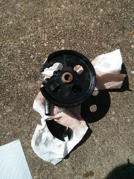

I tried to do it while still on the motor and used a screwdriver to keep it from turning. Unfortunately my manly strength caused this:
So it looks as if I am driving the wife's car for a few days!
Attachment 494213

Well, thanks for the encouragement. I drove the 20 minutes to the Autozone with the one in stock, and then borrowed a pulley remover from the closer Autozone and proceeded to work.I tried to do it while still on the motor and used a screwdriver to keep it from turning. Unfortunately my manly strength caused this:
Attachment 494213
