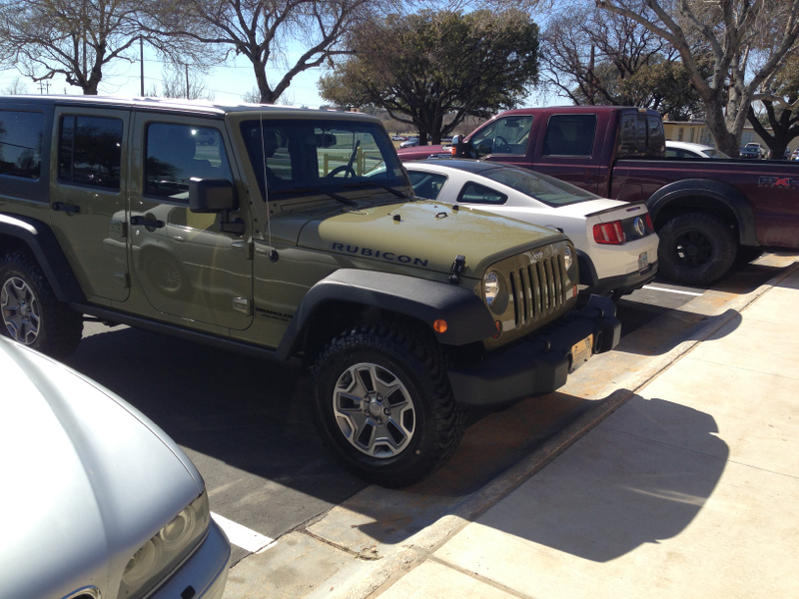

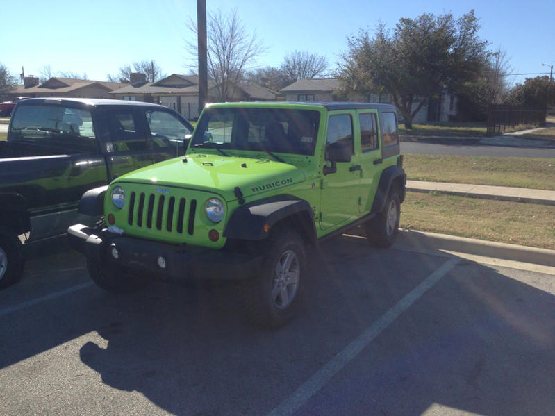

So the dealership replaced the throw out bearing, output shaft and seals. Picked the Jeep back up and it still makes the same noise. Brought it back to the dealership and once again they told me it was normal. I had them pull up a new Jeep to see if I could hear the same noise. I could not hear it and of course the dealership could. So after having the transmission torn apart three times I had enough.
I ended up trading the Jeep in for a 2013 JKU Rubicon. Same payment and still have 8 grand in equity on the new Jeep. Pics attached of old and new Jeep. New one is Commando Green.

Congrats on the new jeep, sucks you had to go through all of that and never get it fixed though. Hope this unit fares better for you.
