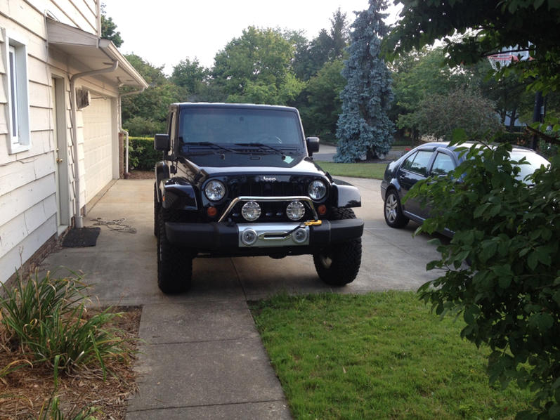

The Q9000 fit in mine... With a little bumper modification
That looks sweet. Would love to do that to mine.
