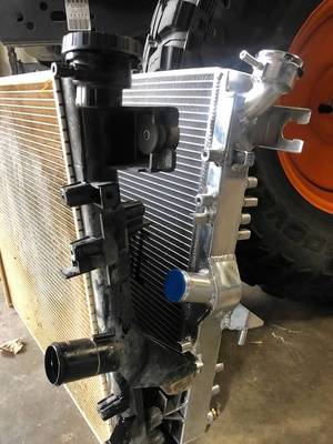

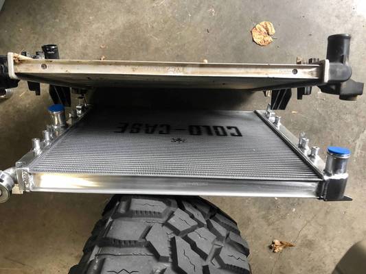

We installed the 3rd radiator in our 2014 about 9 months ago and went with a cold case aluminum radiator. It lowered my running temps pretty dramatically. It fits like factory which is more than I can say about the Omix-Ada replacement we installed before it.
Last week our temps ranged between 95 and 100 degrees, my engine temps stayed in the 212 - 214 range running 75 nekked down the highway in moderate winds. City driving it bounces between 199 and 204 (therm opening and closing)
Tulsa elevation is 700 feet.
Sitting still at a stop light temps can climb to 220ish.
In comparison I'd run 220s to 230s under the same conditions with the factory radiator.
2014 JKUR, 100k miles, heavy build running 40" tires. No fan hacks but recently replaced the therm, hoses and coolant.
