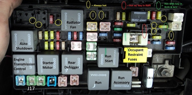

Does anyone have a picture of the fan relay and where I can find it? I'm having a hard time locating it
I keep this pic of the TIPM on my phone. See if it helps. I think Ronjenx put it together.

Old Dec 17, 2015 | 05:16 PM
JRJKUS's Avatar
Joined: Jul 2014
Posts: 173
From: Chicago
Good pick to have. What year is that from?
Sent from my iPad using JK-Forum
If I'm correct about Ron putting this picture together, and if I'm correctly remembering, he had a 2007 TIPM that he did the analysis on. He does own a 2008 JK. Maybe he'll chime in.
I don't recall for sure if it's 2007 or 2008.
The layout of the fuses and relays hasn't changed through the years. Last time I checked was with a 2013. It was the same, too.
I think VancouverRubi was asking for a picture of the high speed relay's location, behind the driver's side headlight.

Originally Posted by ronjenx
I don't recall for sure if it's 2007 or 2008. The layout of the fuses and relays hasn't changed through the years. Last time I checked was with a 2013. It was the same, too. I think VancouverRubi was asking for a picture of the high speed relay's location, behind the driver's side headlight.
Yes, if anyone has a picture handy of the high speed relay. If not, I'll pop the hood again tomorrow and take a closer look
