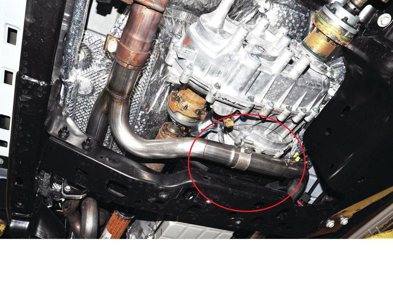

It's your heat shield of your y pipe. they are known for the welds braking off. You can either weld it back on to your exhaust, pry it off, or clamp it back into place. if your look at the picture I posted it would be where I circled.
