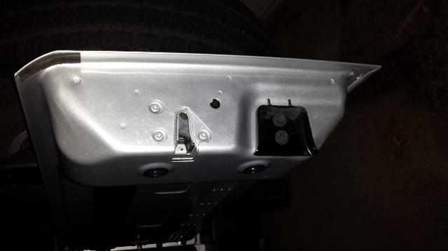

I found the noise. It is coming from the black peace on the end of the gate under the latch. Has anyone seen this and what is the best way to solve?
I used two thin strips of Velcro fuzzy side on the inside. You can adjust the striker side.

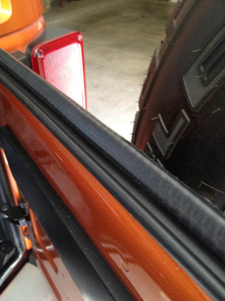

I went to the junkyard and picked up a rubber door molding (it doesn't matter what it comes off of) for $5.00 and installed it on the upper lip of the tailgate, not only did it eliminate the squeaking of the rear window rubber against tailgate metal, it also sealed up that area much tighter
