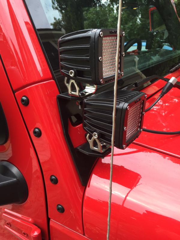

Was the windshield hinge plate. Thank you for the advice, I found most of them were looses during the install of some lights

Actually no it was the the curved piece between the cowl and the fender. It bolts up behind the windshield plate. I sat on the hood while my girl drove around in a field and just started taking parts off till we found it. I put some thins adhesive weatherstripping behind where the plate bolts under the cover and it has completely stopped. I'll take pics later
