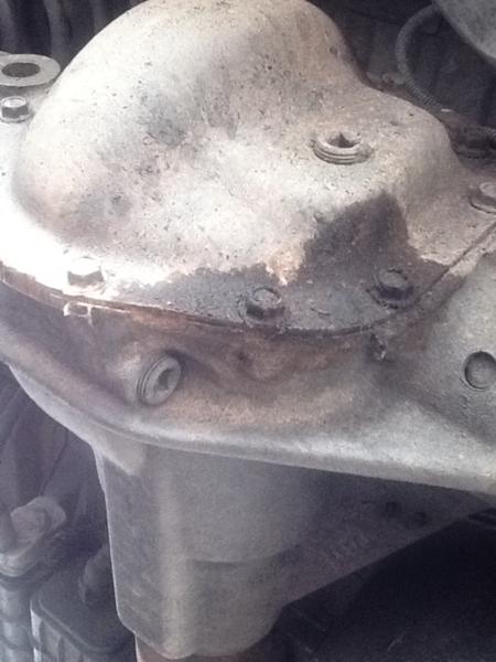

Woke up this morning and noticed some seepage from my rear dif.. Just had the jeep off road yesterday and might have banged the thing on a rock taking a bad line.. Anything to be worried about or should I just tighten/clean up and watch it like Nexian had posted. It sat over night and there's no sighns of drips on the ground.
I wouldn't tighten the bolts, you could break them off in the housing, you need to drain the fluid, take the cover off, clean the RTV, apply new RTV and fill it with new fuild.
Had to do mine last Thursday with only 2500kms on the OD

If you do want to get it fixed, taking it to another dealership might be a good idea. I took mine in twice for this same thing and they fixed it without giving me any trouble at all. And I don't even consider my dealership to be a good one since they won't address my oil consumption or corroding hinges. I'm surprised they told you they wouldn't fix it. But, like everyone else is saying, it's also really easy to do yourself too.
