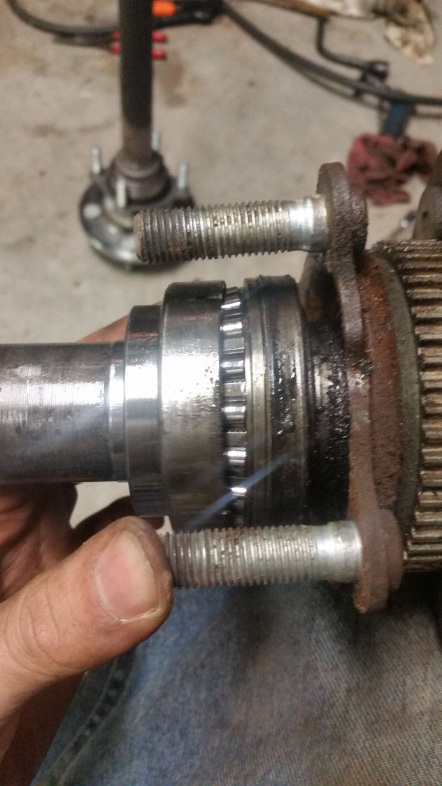

You've got a few things, but I'd pull the rear tires off and see if you've got what I had. A bent flange can cause weird feelings.

Thanks i did remove both tires and put it in gear. Both sides look normal.
