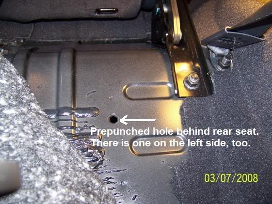

If yours didn't come with them, you may have the holes to mount them under the carpet.

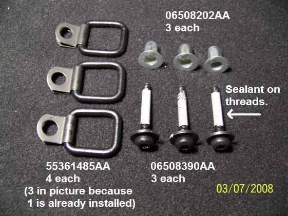

I also added these for bigger loads.
https://www.jk-forum.com/forums/show...o-Tie-Down-Mod

Originally Posted by ohlhockeyguy
Thanks. Where did you get the tie downs?
I was hoping the inclusion of the part numbers would imply the dealer was the source. $20 total is what I spent.

$3.10 each from Chrysler.
