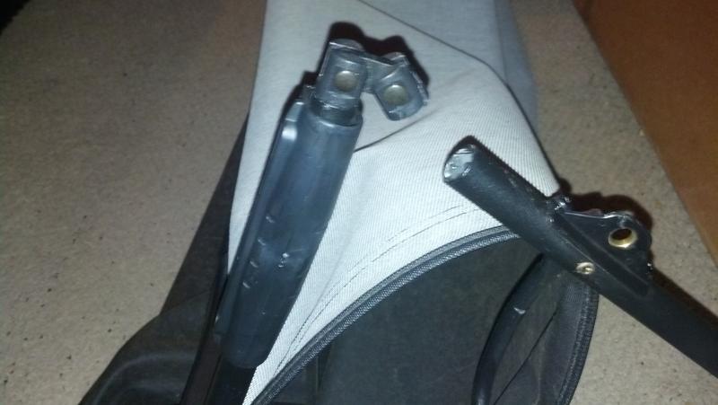

I have a 2012 Wrangler 2DR, with a soft top.
I removed the top and I accidentally broke the pivot hinge on one of the sides when folding the top up.
It is the pivot hinge that is used for folding the front section of the soft top back when it is on the Jeep.
When I took the top off and released 1 side (with the plastic slide handle) to fold the top up it cocked the other side and broke the hinge.
It seems to have happened pretty easily, especially when the top is off the car. I doubt if I am the only one who has done this (I hope), so I hope someone has info on what it takes to replace it.
I notice there is a screw on the back section of the pipvot hinge to dissemble it (I assume), but I don't see any way to take it off from the front section (where the plastic sliding handle is).
Is this pivot hinge a single replacement part, does anyone know the part number and if only the hinge is replaceable?
Thanks...

It is the "pivot hinge" (kind of like a knuckle) that the plastic slide handle releases. When you pull back on the plastic slide handle it release this "pivot hinge", which allow the front part of the soft top to fold back.
This slide handle is on both sides and is used when you want to fold the front part of the soft top back when it s on the Jeep.

You might want to stop by a junkyard or those places that sell salvaged parts. They might have a soft top with a ripped fabric or damaged somewhere else and sell it cheap or even give away to you.
Part Description: "Link-Pivot, Sunrider Top"
Part Number: 5166017AB
List Price: $35.95

Cool! Thanks for posting the part number. What an adventure!
You would think that the dealers would have more than one in stock or at least more dealers would have at least one.
