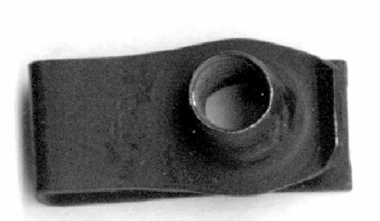

Advance auto parts or any large chain autoparts will have these body bolts. The bolts are 8X1.25X30mm with 13mm hex head. The U-nuts are 8X1.25mm. The bolts wholesale for $12.50 box of 30 online. The u-nuts go for $12.95 for 30. autobodysupplies.com

Thanks TINMAN! You were absolutely right. I found them at Pep Boys. I never would have thought that these big auto part chain stores would have carried something like this. I haven't ever really looked around that much when I was there for the basics like oil, coolant, wipers, etc. I guess I need to start paying more attention. Thanks again. Cheers
For future reference:
(6) Body bolts: M8x1.25x30
(4) U nuts: M8x1.25
(12) Washered nuts: M6x1.0
