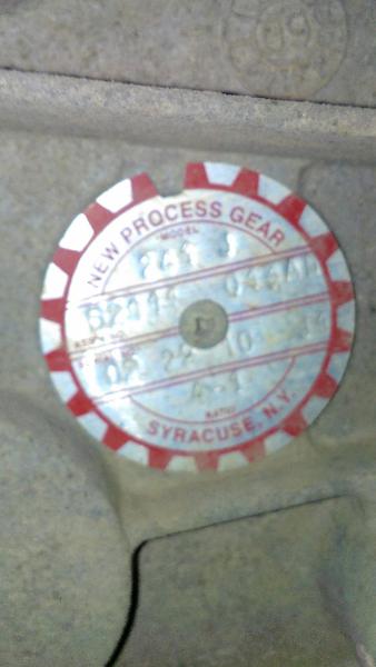

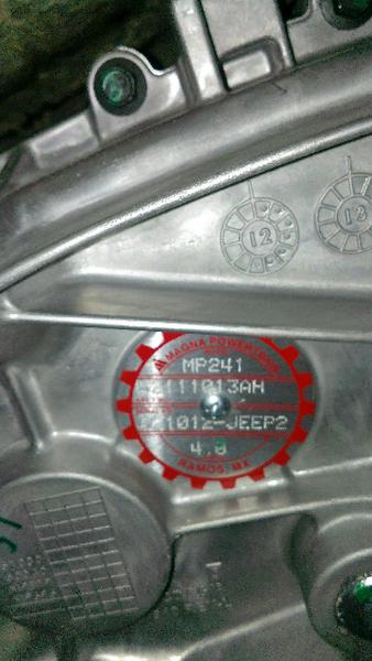

so I just got my transfer case replaced thru Warrenty cause it was shot. The original T. Case tag said "241J / 4-1 ratio" the new one is marked "MP241 / 4.0 ratio" is this the right case? I'm confused.... So I gotta call and ream someone out tomorrow at the dealer?

Old tag

New tag

The New process factory closed sometime in 2012, now Jeep/Chrysler uses Magna Powertrain for it's transfer cases and the ratio changed.
you got the right transfer case. Just an updated version. Rubicons are 4 to 1 ratio and the sports etc are 2.72 to 1.

Thank you, I was just back at the dealer cuz it still grinds, now they saying Drive shaft. But I did look at a new Rubi and it says 4.0 also
