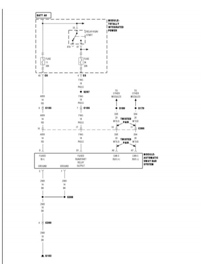

Lightbulb Wiring diagram
Maybe the diagram below will help too, it looks like can bus and two fused B+ circuits. OBD2 Software (Appcar DiagFCA) that can activate it directly for a test, and read the switch input might be handy -- I'll double check DiagFCA has this capability if your thinking more diagnostic tools will help. There might be some advanced error codes (not readable with the key dance or typical readers) that will help as well. But I'm kind of thinking that if fuses are good and you hear some motor action in the swaybar, the problem is in the swaybar itself. Somewhere (maybe from RonJenx) there was some info on opening it up for cleaning and greasing. If mine begin failing, that's the direction I'd lean.
