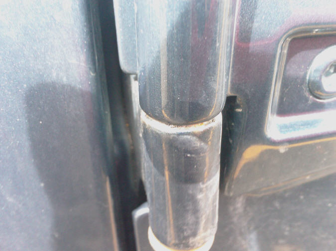

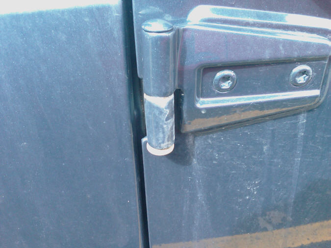

took some pics at lunch. sorry for the poor quality had to use the camera phone.

But all the hinges look like this.

Oh, hell. Those look just fine! The little o-ring is what you're seeing the rust come from. Nothing to sweat.Oh, and when you have a chance you might want to wash it just this once so the oxidation doesn't stick. A little Mothers or some Turtle will do the trick!
