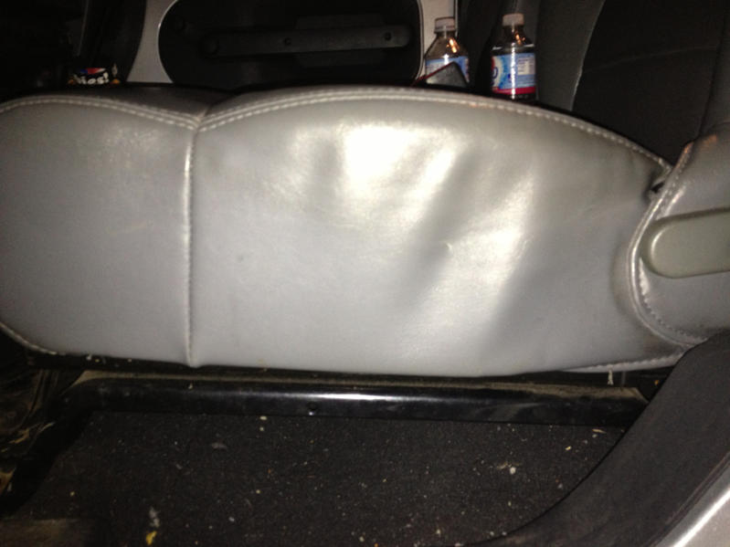

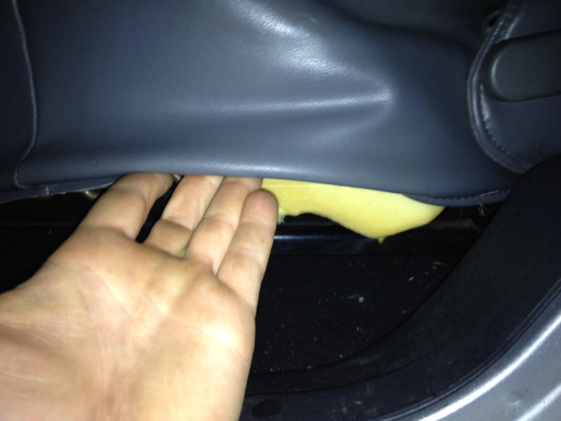

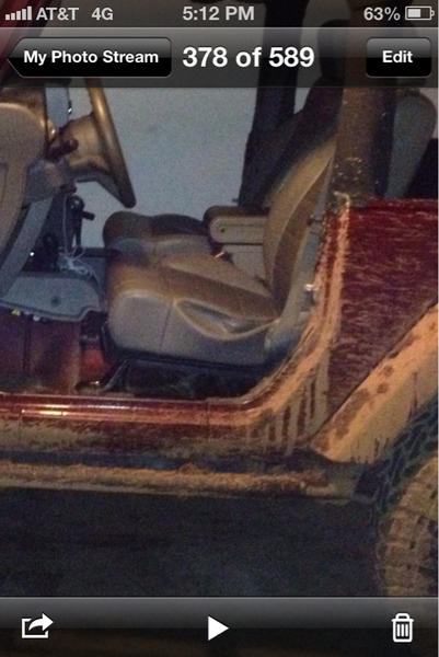

So I have been haveing this problem and its driving me crazy. My seat comes " untucked " and the foam gets out of place. I have the leather seats in my x. first and second pic is the seat untucked and the last pic is how it's supposed to be. I'm constantly having to re tuck the leather in and put foam back in place any help. Makes me wanna get new seats.

Not a big solution. My was doing it and had the foam coming out. Got tired of messing with it. Just took out the foam that was making it happen and problem solved.

That lower edge of the seat cover should have a harder plastic piece that is sewn into it that clips into a section under the seat.
if it is worn out and not holding it anymore then you could use a few short self tapping screws to hold the plastic clip strip and retainer together. I have had to do this on some of the vehicles. at work.
edit... If it doesn't have the plastic retainers then you could get some eyelets attach them to the leather towards the bottom seam. for that amount of leather piece 3 or four should do. Then run zip ties through the eyelets and attach to a few points up under the seat that doesn't interfere with the seat sliding back and forth.

I have the hard plastic piece and it will hold but no long/ well think I might try some way to make it stay. Thanks for the idea

That plastic retainer, which is the same on the cloth seats, has to be pulled back, held on an angle and pushed/snapped into the metal retainer. If it's pushed straight in it won't hold. If it's done right you'll actually feel it snap into place.
