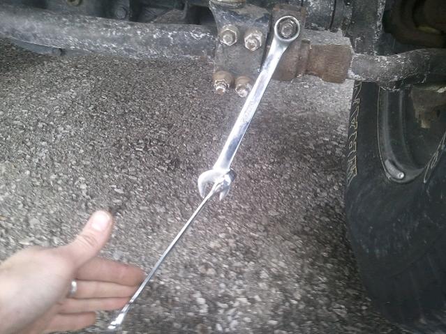

Take 2 wrenches and put them together box end to open end to make a generic breaker bar.
This works.
Another way it to put the box end of the wrench onto your socket
