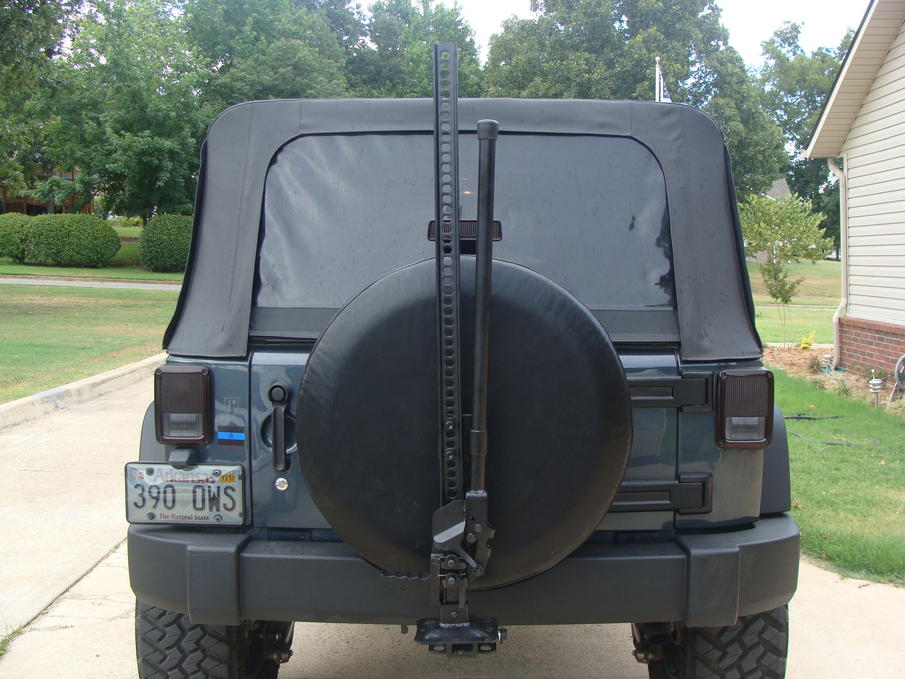

All tail lights must be visible for 500 feet and have a red tint to them . I am a Cop and tinted mine what I did was to tint them at night pre-prep your tail lights during the day then tint them at night . look in between coats and if they look to dark then let dry and sand a little till they are bright enuff . Be honest with yourself when you are judging if they are bright enuff , because if you have any doubts you could get a ticket. Basic rule no when to say when LOL.

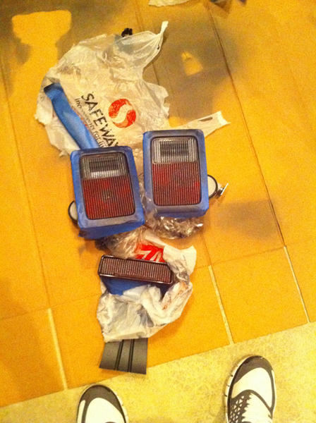

Hey guys, my first post here, thought i'd add to this thread as i just did a tint job on my taillights on my 2010 rubi unlimited. I've had it less than a week and so far i LOVE it. This VHT method is a great way to add some nice tint to your lights. I did a little bit of sanding with 2000 grit sandpaper, but it is kinda wonky on the taillights because of how grooved and bumpy the taillights are, but im sure it helped the paint stick. I bought clear coat but didn't use it as i found that it looked decent with just the VHT on it. I might go darker in the future, but for now im pretty please how it turned out. Check it out and let me know what ya think!

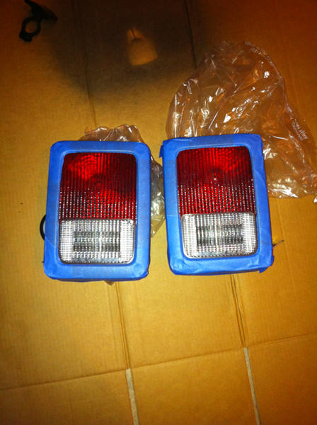

Masked off and ready for paint:
I masked off the ring around the light as it is the reflective portion of the light and i wanted that to remain as reflective as possible for safety reasons.

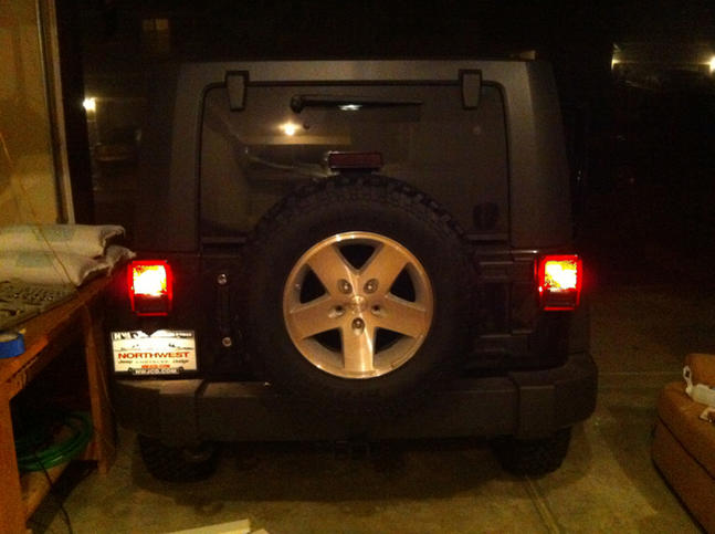

Running lights on:

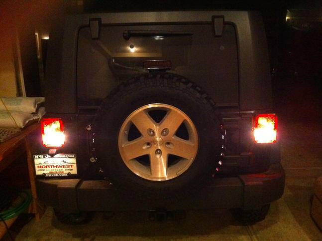

Brake lights on:
Reverse lights on:

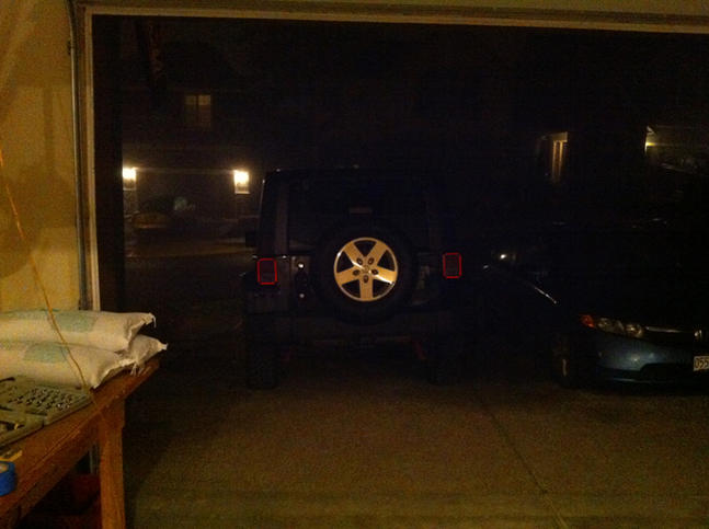

Outside in the dark:
