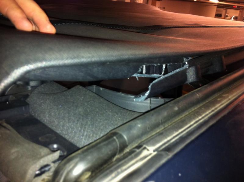

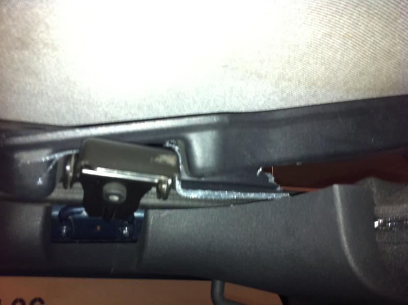

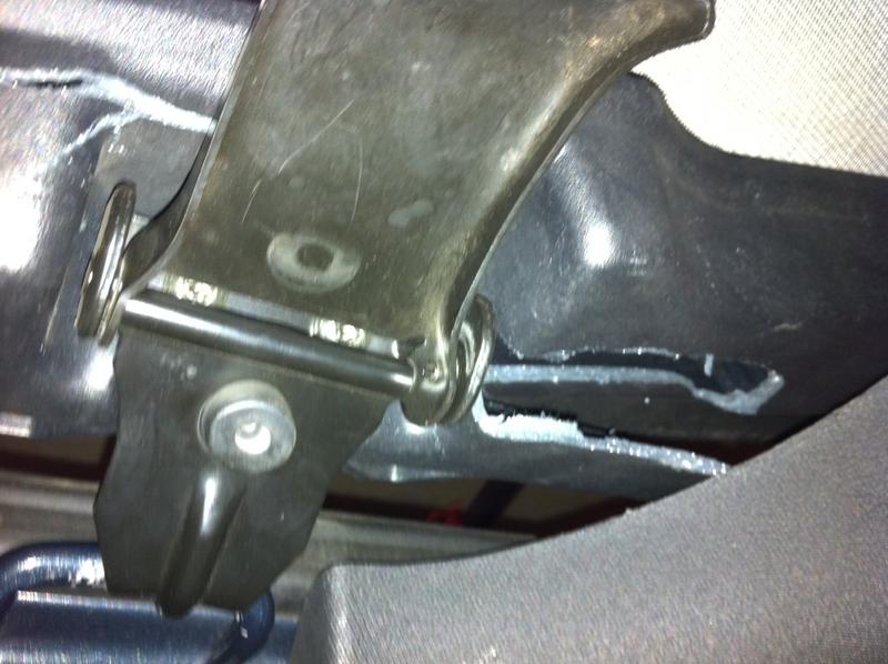

Hi All,
I am new to the Forum (as a member) and recently have had some troubles with my soft top. I have searched and found some topics about the plastic vs metal header and other miscellaneous items but have yet to see a topic about my issue. Yesterday I was putting the top up and performed the necessary steps (latching front but not all the way) and when i went to the rear to put the sail panel on, my plastic windshield header piece snapped! Now the top is inches from connecting with the top of the windshield and when i latch the top, there is no tension to hold the right side down. I am using ratchet straps at the moment to keep the top relatively close and to prevent the top from destructing at highway speeds.
Has this happened to anyone? Does anyone know if i can get a new full plastic header piece (maybe with metal connector from the TSB) anywhere online?
The canvas seems to be intact with no rips or tears, and the screws seem to still be holding everything together, so if possible a new plastic piece would be sufficient as the latches and what not are still in good shape.
Any help would be appreciated! Thanks!
Here are pics:

man that sucks. sorry to hear that. Quadratec sells new headers
http://www.quadratec.com/products/11132_9113_07.htm
Thanks! I was searching yesterday forever and couldn't determine if the part #68049276AB was just the metal piece or the entire header piece. I read everywhere that there was a TSB covered under warranty to replace the plastic header with the metal header, but i figured it was only part of the header and not the entire plastic piece that holds the latches. Thanks for the info, $125 from quadratec's website.
Update: I bought the piece from the Jeep dealership for ~$150 including tax. It was raining yesterday so I haven't had a chance to install. Funny thing is, the part is the same piece as needed to go from the plastic header to the metal header and I was actually looking at upgrading before I even snapped my header! Funny how things work out. I'll post an update to how difficult this is to install; I'm going to use some tips and tricks from other threads on this forum. Thanks for all your help!
All of the headers are plastic, the "metal" one that you are referring to is a redesign of the skeleton of the inside. previous headers were straight plastic with the clamps just screwed into it. now there is a metal brace inside the plastic header now they mount to for more rigidity.
