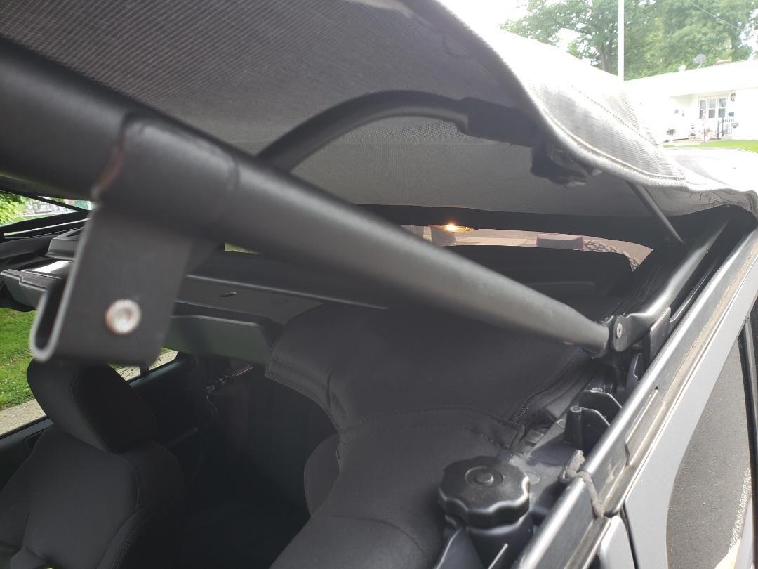

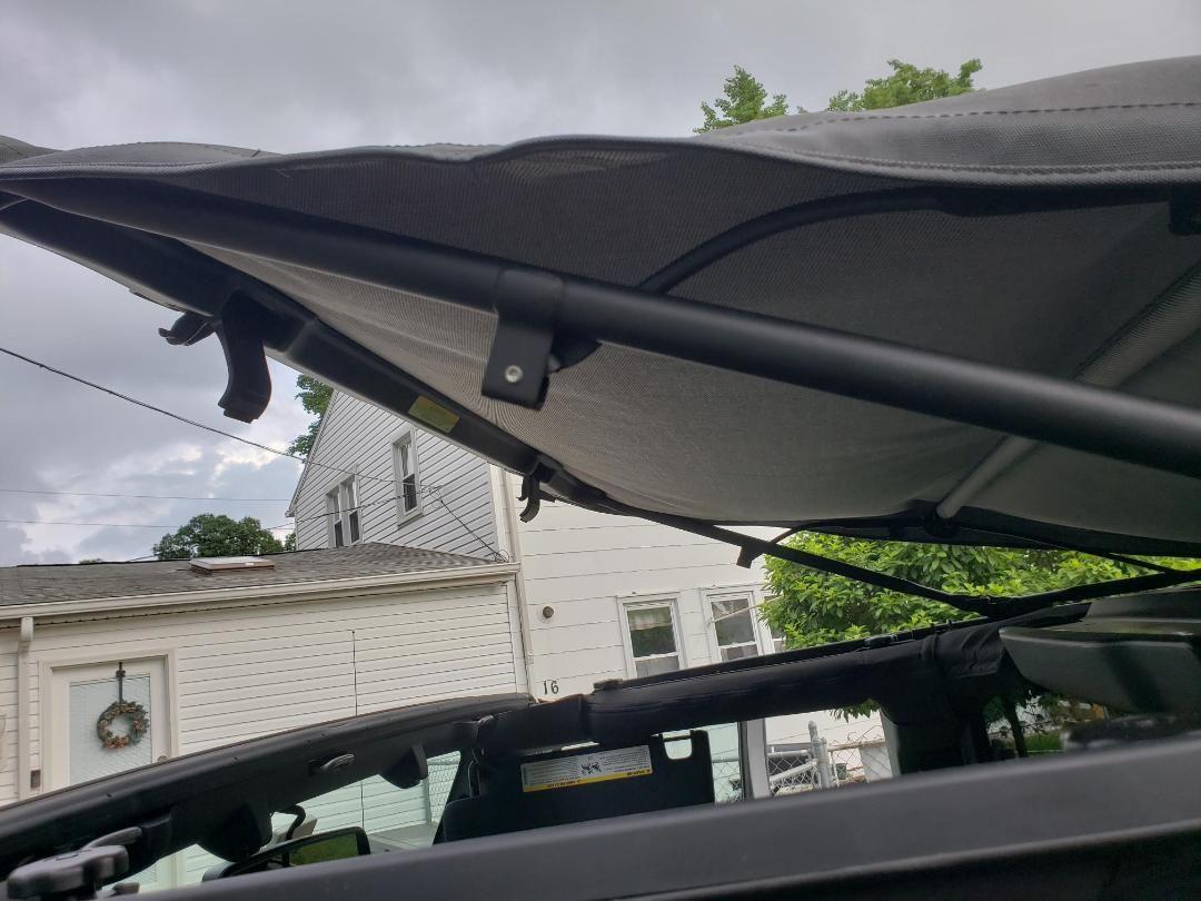

Ok I just checked and I don't have those tabs so I'm assuming my top is 2010 or newer like my door surrounds. I just took pics, I'll try to figure out how to load them.
Old May 31, 2018 | 01:59 PM
mpd2434's Avatar
Joined: Sep 2016
Posts: 74
From: Audubon, NJ
Here are the pics.
