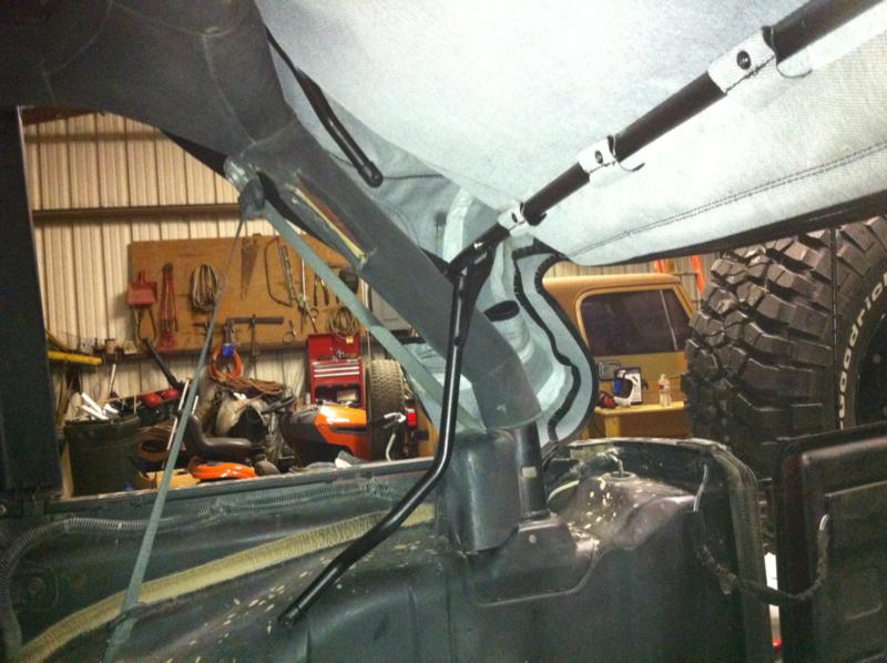

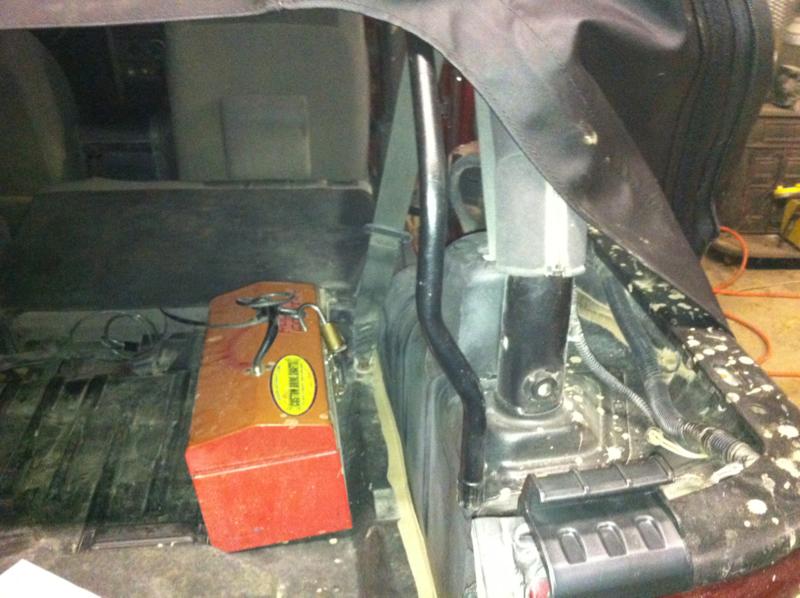

Looks like you're still online, so let's talk thru this one. Snap some quick pics. I have a soft top that I run year round but I can't go get pics with the rain and such here.
Did you have a soft top before and what is it that has you perplexed? Is it the assembly of the top or putting the top onto the jeep?

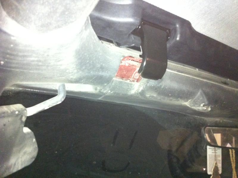

Pic 1: I cant seem to get the hooks to reach the loop to clamp down.
Pic 2: this doesn't look right...shouldn't these two bars be connected??

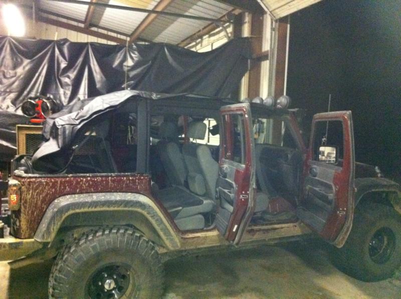

Pic 3: overall pic of where im at so far.

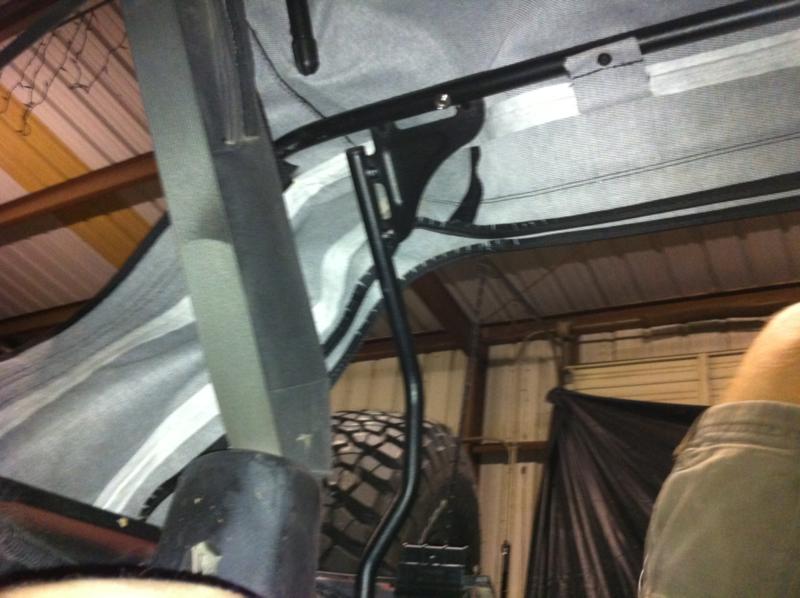

Pic 4: back end again...it's the part that's giving me problems.

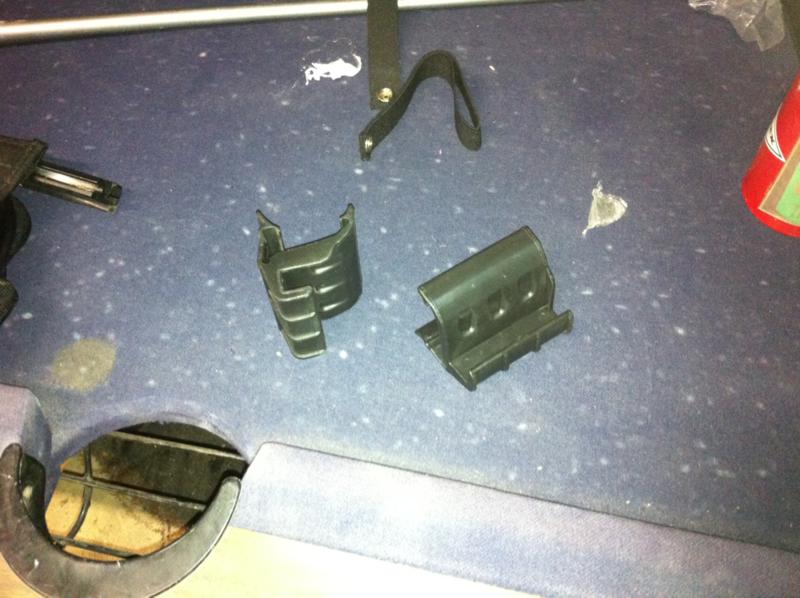

Pic 5: what the heck are these??
No, I've had a hard top since I got the jeep. I'm just kinda in the dark here.

Pic 1:
Open the clamp piece up then it snaps closed to latch the top on
No, they each sit on little metal tabs somewhere on your roll cage (outside of the rollcage) I have a 2dr so it is a little different
These go on either side of the tailgate, if you look you'll see the metal is notched. They are side specific and will only slide but so far. They hold the tailgate bar into place.

1: I did, still about a half inch away...might work of I get the rest if it on first.

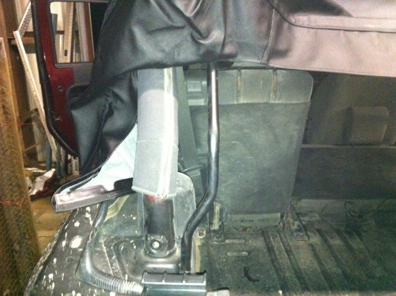

2: there's no way it'll fit on the outside, it's too narrow. I'll take another pic.
5: I got em on.

Ok, it looks like their bars are held together on some sort of brace/swivel thingy....aaaaand I don't think I have said thingy... :\

Ahhh, I didn't know that either. Maybe having a 2dr guy try to help get a 4dr top on wasn't my best idea lol
Haha, it actually was a lot of help. At least now I know it's not JUST my ignorance that's holding me back; it's also some missing pieces. Lol. Thanks a lot for your help.
Old Aug 27, 2011 | 09:10 PM
c-mack's Avatar
Posts: 262
From: Lovelady, TX
Looks like I'm gonna need 4,15,16,&17......joy. Thanks so much Karl!
