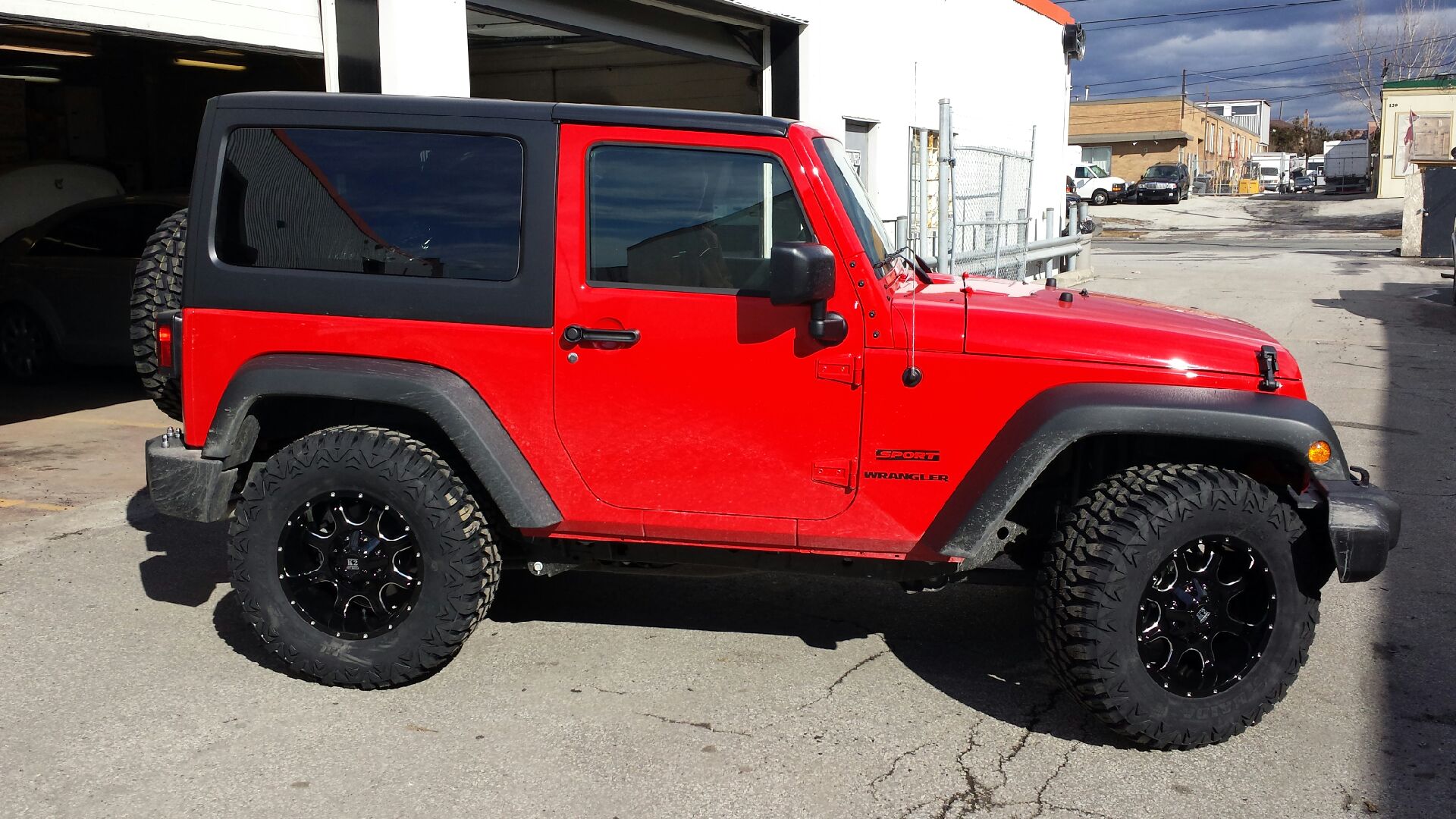

My thoughts
Go with good 33s with a proper back spaced rim
you get good looks , good off road , and you can run stock suspention and gearing.
Then if you want more you can add the extra ~ $5000. more to do the gear and lift.
Remember when you lift you change the caster and wheel base pinon angles and so on. So you have to do it right if want to dive it on the road every day and feel half ass safe.
just my thoughts
Have fun its a JEEP Click image for larger version
