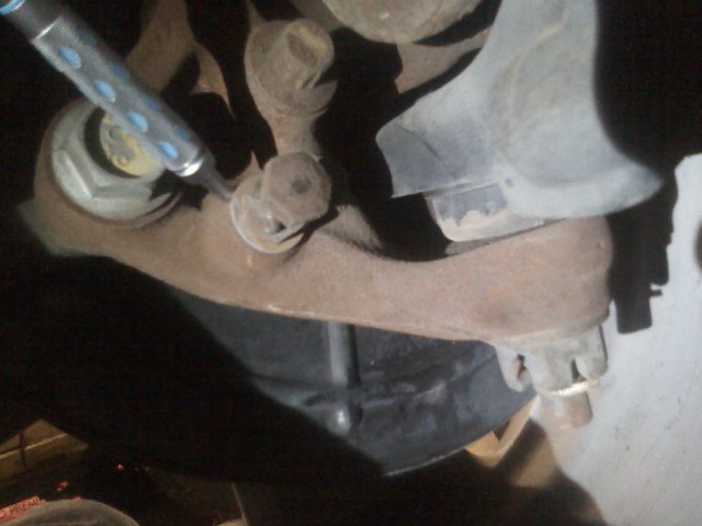

That rub can be fixed by adding a thin washer under the steering stops. Takes about 10 minutes, I think I used a 5/16 washer. Very slight increase in turning radius, but in 4WD that slightly less angle is easier on the front axle u-joints.

Can you please explain how to do this? I have 1.5" spacers/stock wheels/35" and also rub when turn all the way. Not sure what the steering stop is, pics? Thanks.

The stop is a bolt with a nut spot-welded to it, you can see the stainless washer (that was added) right where the pencil is pointing.

Awesome, thank you. I will be doing this this weekend. A quick fix until I get
Bushwackers/wheels. The rub gets annoying after a while and people look at you like you hit something.

Here is a write up.
Project-JK.com - Jeep JK Wrangler Resource » TECH TIP : Jeep JK Wrangler Steer Stop Adjustment
