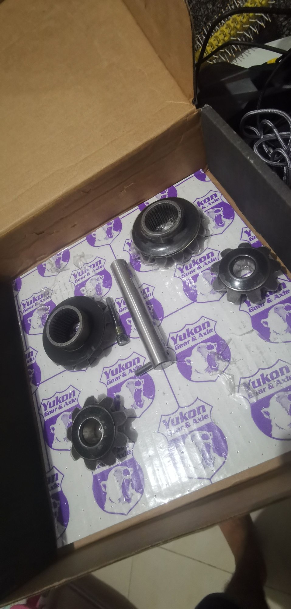

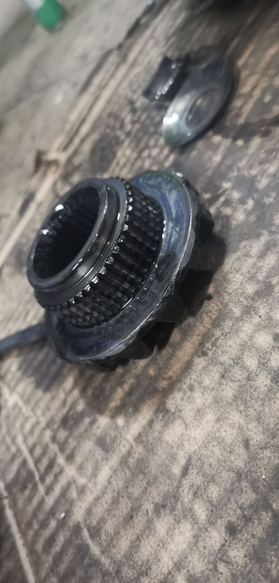

OK so I planned to change my spider gears and ordered open differential spider gears instead of anti slip trac lok spider gears for my jk 2009 Sahara. Can anyone confirm what's the correct gear I should order and help me find out the gears in stock and ready to ship to Qatar? It's been a week now my jk is still in the garage. I am posting pics of my current gears and the Yukon gears that I ordered online.
Yukon spider gears that I ordered online won't fit
My current gears and carrier

I would say that you have t simply re-order the correct gears for an anti-spin unit and return the ones that were delivered. No Jeep dealers in Qatar?

Unfortunately the dealer here is soo shitty that they are always out of stock. I have to order from states. Ordered complete carrier
POWERTRAX GRIP PRO LIMITED SLIP - 3.73 and Down and hope it fits my current setup. I am having stock gears 3.73 now and the supplier said it will fit. Let's see

That sounds like the best way to go and allow time to get the other diff fixed as a spare or sell it.
