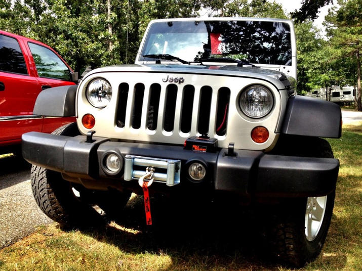

I used the Smittybilt one. Bought it off Amazon for around $120 if I remember. You do have to cut slots in the stock bumper but they are covered by the mounting plate. I'll post a pic in a minute.
Old Jan 20, 2013 | 03:32 PM
Gman*2007's Avatar
Posts: 2,552
From: Huntsville, TX
Here is a picture of the smittybuilt I used when I had my stock bumper on.
