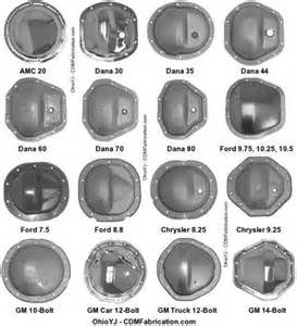

Jeep.com shows the 30 standard in the front and 44 in the rear... You can look at the bolt pattern to tell the difference.
