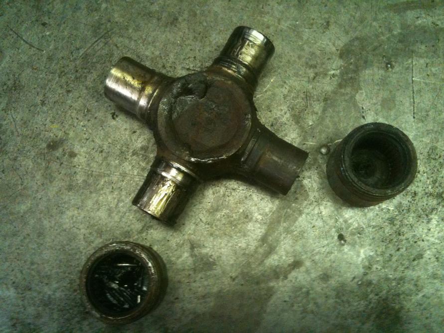

Old Sep 2, 2010 | 09:42 AM
Banny568's Avatar
Posts: 19
From: Italy
Resolved!
Only U joint damaged
In the photo is visible…
