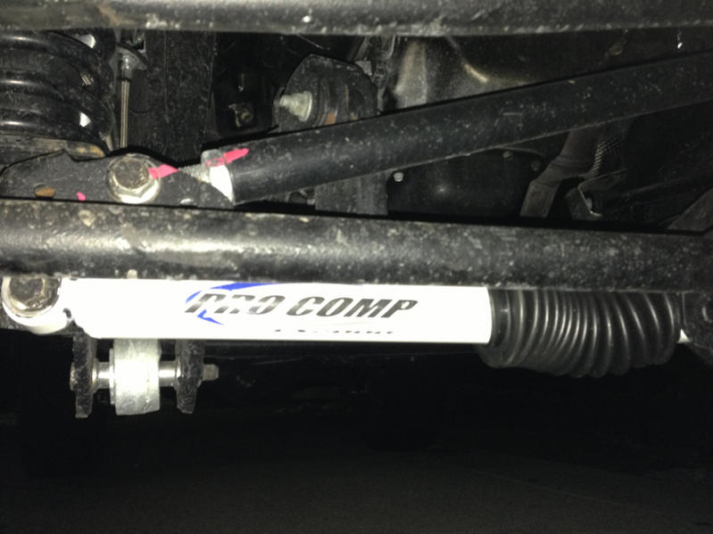

Just installed the 40$ pro comp stabilizer. This thing is great! I can't believe I was going to spend 370$ on the new fox ats. There is no pull at all being oil filled. The steering feels like stock again after 3.5"lift/35" tires. Highly recommend.
