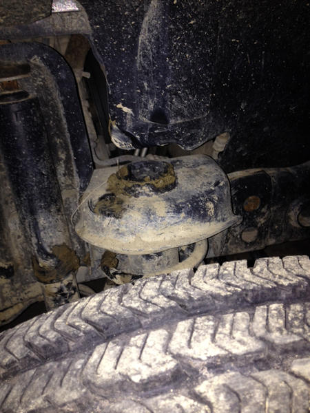

Going to try the sprinkler tomorrow when its in the 40's. I noticed mud in the cylinder (i don't know whats its called) above the jounce bumper . How can i get that out? I got as much as i could with my fingers but there's more in there.

Here's what I'm talking about. Mud is inside that hole.

Pic..

That hole is the bump stop mount and mud there would not cause a vibration.... However, I can see from the picture that you are no where near clean enough to rule out mud as a source of your vibrations and steering wheel shimmy.
The inability to properly clean is what keeps me off the trail in the winter... I know it will be tough but it really needs to be done. Dress warm, put on a rain suit and go for it!

Power sprayed whole thing and got it up to 65mph with no wobble. I think that's fixed.
