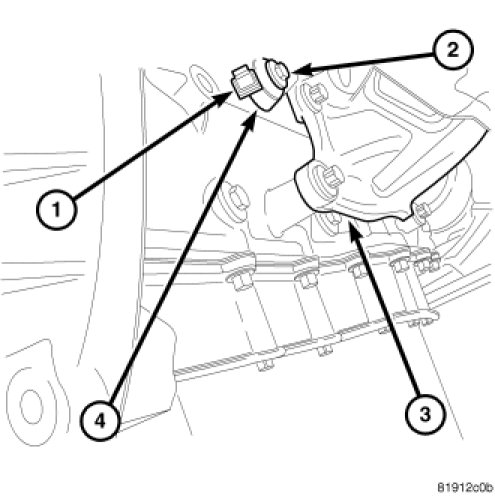

Only one knock sensor (4) is used. It is located on the right side of engine block, to the rear of right engine mount (3).
1.Disconnect negative battery cable.
2.Raise vehicle and support.
3.Disconnect electrical connector (1) from knock sensor.
4.Remove mounting bolt (2).
5.Remove sensor (4) from engine.
