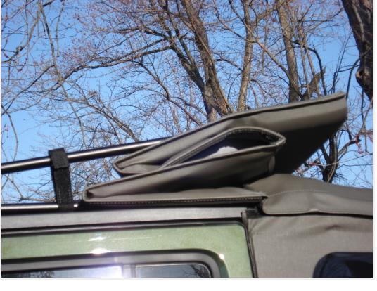

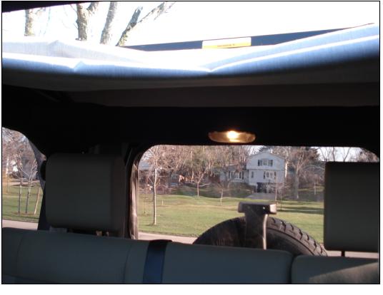

I have a droop as well. Here are some pics. Appreciate the help
Yeah, that isn't right. Your "W" is wrong.
I'm at work or else I would post a pic.
The first fold starts right by where the front conection is. You can see it in your first pic.
If someone doesn't post a pic I will try to later

Cdash's Avatar
Joined: Dec 2006
Posts: 321
From: Milford, MI
I posted to the other place you had this question, so look there, but to answer here in a shorter way:
In your first picture, your W goes from the top bow, then towards the front of the Jeep, bends to go back to the bow, the bends to go back forward then bends to go to the back. (go ahead and trace it with your finger)
It should go from the top bow BACK towards the BACK of the Jeep, bend and come forward to the second bow, then BACK towards the BACK of the Jeep back to the bows.
When you lift the header and fold it back, you want the material to fold UP (which ends up back) NOT THE NATURAL FOLD DOWN THAT IT WANTS TO DO BY ITSELF!!!
If you don't get it from this, trying reading my response at the other fourm. Just be patient and watch what the tops wants to do and make it go opposite. You'll get it and it'll be a snap afterwards!!
