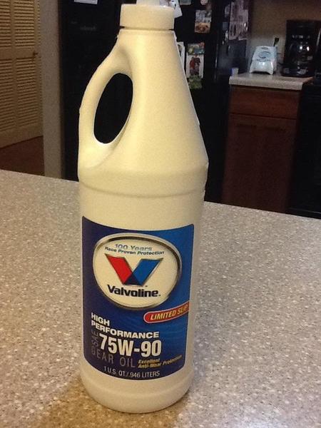

I'm sorry. It's not synthetic I picked up on sale but this

Old Apr 8, 2015 | 05:25 PM
jeepmojo's Avatar
Posts: 2,318
Likes: 12
From: New Hampshire
Default yep thats what i use too
good to go you could use a heavy gear oil in rear if you wish 85/140 but your still ok i believe with 75 /90 in both
i replaced with 85/140 in rear diff
Old Apr 8, 2015 | 05:34 PM
Jeremi414's Avatar
Joined: Feb 2015
Posts: 62
From: STL Missouri
Thank you sir
