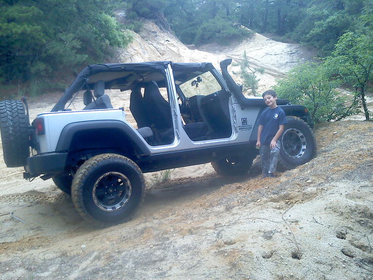

Nothing to it . I use a SMALL amount of never sieze on the hinge pin. So the next time you take the doors off it will slide off easy. Just try not to get it everywere. Once you have the doors off you wont want to put them back on . See what I mean??
